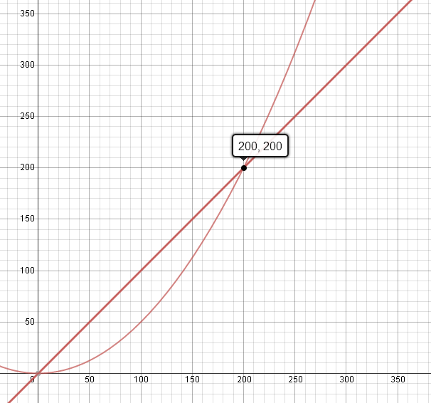

If quantum vacuum (energy) fluctuations can be pushed then you have IMO a 'free energy' zero point energy machine where speed (v) is directly proportional to energy. The kinetic energy of that system can be extracted at KE = 0.5 • m • v2. The kinetic energy of an object is directly proportional to the square of its speed so for a fourfold increase in speed, the kinetic energy will increase by a factor of sixteen with energy input increases linear with velocity, constant power to produce constant thrust and no propellant.
Kinetic energy would exceed input energy at some point if it worked.

It's not being overlooked but the odds of it being utilized by a simple resonant RF cavity (like the EM Drive) is pretty small.
https://en.wikipedia.org/wiki/Quantum_vacuum_thruster
Fringe science explained here: http://arxiv.org/pdf/1012.5264v1.pdf
2. PROPELLANTLESS PROPULSION 2.1 Global Constraint Regardless of the mechanisms that might be entertained with regard to "propellantless" or "field" propulsion of a spaceship, there exist certain constraints that can be easily overlooked but must be taken into consideration. A central one is that, because of the law of conservation of momentum, the center of mass-energy (CM) of an initially stationary isolated system cannot change its position if not acted upon by outside forces. This means that propellantless or field propulsion, whatever form it takes, is constrained to involve coupling to the external universe in such a way that the displacement of the CM of the spaceship is matched by a counteracting effect in the universe to which it is coupled, so as not to violate the global CM constraint. Therefore, before one launches into a detailed investigation of a proposed propulsion mechanism it is instructive to apply this principle as an overall constraint to determine whether the principle is violated. Surprising subtleties may be involved in such an assessment, as illustrated in the following example.
2.2 An Example: "E H× " Electromagnetic Field Propulsion
A recurring theme in electromagnetic propulsion considerations is that one might employ crossed electric and magnetic fields to generate propulsive force, what we might call E H× propulsion. The idea is based on the fact that propagating electromagnetic fields (photons) possess momentum carried by the crossed (orthogonal) E and H fields (Poynting vector). This raises the issue as to whether static (i.e., non-propagating) E H× fields also constitute momentum (as the mathematics would imply), and in particular whether changes in static fields could result in the transfer of momentum to an attached structure.
Pursuit of the linear thrust possibility, however, leads one to a rich literature concerning so-called "hidden momentum" that, perhaps surprisingly, denies this possibility.7 The "hidden momentum" phrase refers to the fact that although the linear E H× fields do carry momentum as in the angular case, the symmetry conditions for the linear case are such that there exists a canceling mechanical momentum contained in the structures even though a structure's CM itself is stationary (see Appendix A). Specifically, it can be shown on very general grounds that, contrary to the case for angular momentum (e.g., the Feynman disk), the total linear momentum of any stationary distribution of matter, charge and their currents, and their associated fields, must vanish. In other words, barring a new discovery that modifies the present laws of physics, any such distribution cannot generate a propulsive force without emitting some form of reaction mass or energy, or otherwise imparting momentum to another system8 .
Eqs. (A5) and (A3) demonstrate that the electromagnetic momentum is balanced by an equal and opposite mechanical momentum. Because of its rather obscure nature, this momentum has been referred to in the literature as “hidden momentum”. This is a particular example of the general result that a net static linear field momentum will always be balanced by an equal and opposite hidden mechanical momentum. In practical terms, this means that the creation of linear field momentum cannot give rise to motion because the field momentum is automatically neutralized by a mechanical momentum hidden within the structure, so that the whole system remains stationary. This inability to utilize linear field momentum for propulsion is guaranteed by the law of momentum conservation.
