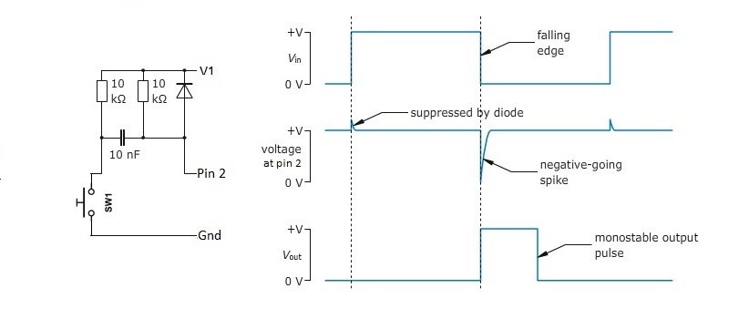

I found this circuit for a differentiating input to generate a short pulse rather than continuous signal from the switch - this should solve the issue?

basically the problem I am now having is that I just want it to give a single pulse with each contact with the touchpad, rather than continuously pulsing

It is working fine with a tap, I would like it to latch when you keep your hand on it so it just does a single monostable pulse then stops until you lift and recontact the pad

When your finger is held on the touchpad, is the 555 pulsing or just staying on, like you stated in post #31?
The latter makes more sense.
When the 555 is configured as a one shot and the trigger remains on, the output will remain on as you have noted.
What you need is to set the trigger through an edge detector. This will only output one pulse while the trigger input remains set.
This article on AAC shows such a circuit. It might even replace your 555 circuit, if the output pulse length isn’t critical.

12V DC power supply. The trigger pin needs a very weak pull up to have enough sensitivity for the touch pad to work
Hi
Ok...try this. I'm assuming the touch switch is open and goes to ground when touched. If not, we'll re-arrange the circuit.
Once again, the pot adjusts sensitivity. If the touch pad is tapped or held pressed, it should trigger the 555 once.
see below.
eT
edit:fixed
