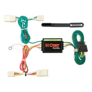

I bought a CURT custom wiring harness that plugs into vehicle tail light assembly to provide a 4-way flat socket. It has a simple plug&play design that eliminates the need for cutting and splicing of the car's original harness. It provides a wire for left turn/stop, a wire for right turn/stop, a wire for tail/side markers/license plate, and the 4th wire for the ground. Basically this 4-way socket was supposed to be used as in the diagram provided by this link.
The problem is that I am supposed to hook that socket into a trailer 7-way socket (ISO 1724).
Usually I am trying to avoid buying stuff that/if I can make as a DIY project.
Obviously I can bridge few of those 4-way socket wires to the 7-way socket:
  • the white ground goes to the ground (pin #3 on the 7-way socket)
  • the brown tail/license/side markers goes to the brown/black (pin #5 abd #7 on the 7-way socket)
  • the green right signal/stop light goes to green (pin #4 on the 7-way socket)
  • the yellow left signal/stop light goes to the yellow (pin #1 on the 7-way signal)
So far so good. But what about the brakes?
The 4-way provided assembly seems to use the same bulbs, both for turn signal and break/stop light. So when the car wants to signal it probably sends a intermittent voltage through that wire, thus blinking. When the car breaks it sends a continuous (non-intermittent) voltage through that wire to the same common-shared bulb (so we interpret that as "the break/stop light", because it does not blink). This make me think that with a 4-way wiring you cannot have both, the turn signal and break light at the same time, because these 2 functions share a common wire/bulb (as I said earlier, is the car that simulates these functions via intermittent/continuous voltage applied to the wire).
The 7-way socket (see ISO 1724) has a separate pin for brakes/stop lamps: the red pin #6.
So basically, the problem I have is to find how to connect the green/yellow wires from the 4-way socket to the pin #6 on the 7-way connector.
If we assume that we just take the yellow/green from the 4-way socket and to link them to the pin #6 it would mean that (1) the turn signal will behave like the emergency lights and nonetheless the stop lamps will do the same and (2) while braking both the turn signal lamps and the brake lamps will light.
OK, instead of using both the green/yellow 4-way harness wires to hook them to the pin #6 (brake) on the 7-way socket I could use a single one (let's say the Right). This means that while I am using the left turn signal it would be OK, while using the right turn it will flash both the right turn signal lamp but also the stop lights (which will look like the emergency lights). So this option is not working as well.
I don't see any simple solution (a wiring solution) to the problem above. The only way I know it will work is by the means of an electronic circuit that will take the advantage of the fact that the turn signal has a is intermittent voltage while the stop lights has a continuous voltage.
I am not in the electronics but I know how to solder a capacitor and a resistor or a diode to a PCB so I am open to any circuit design that would help me to solve this problem.
Any idea/hint/tips that could help me take the fog from my eyes? Thanks in advance for (1) you patience and (2) for your help.

On a standard vehicle with combination turn/park bulbs, switching between brake and turn signal is handled by the turn signal switch. The turn signal will still override the brake light on the side to which you are turning and allow the opposite side to act as a brake light.
To my knowledge, on most of the 7 wire connectors, the green and yellow wire still act as your left and right turn as well as your brake signal. Have you actually tested the receptacle to see if this is the case or do you know for sure that yours is connected differently in that it has a separate stop light signal? Sorry I have to ask but want to make sure we are clear. What type of vehicle are you working on?

You need to have a brake controller to power your trailer brakes. Simply putting 12 volts on them every time you touch the brake pedal of the tow vehicle is not the right way to go. Do a Google search of Brake Controller and you can get more information.

So since I posted my question on the CIRCUITS forum I really want to know if in theory I could build a circuit that will intelligently split the current that comes on a single wire into: the turn signal (with regards that when turning the voltage is intermittent) and separately to brake signal (with regards that when the stop light is ON there is applied a non-intermittent voltage on wire).
The simple solution would be to find a car specific harness for 7-way socket but I haven't found yet, so I have to consider making one.
The harness I bought is a CURT 55571 with T-connector. By looking at that picture (see link) it looks like the CURT converter grabs 4 different signals (green,yellow,red and brown, the white being the earth) from the car harness, but unfortunately it converts them to 3 different output signals (like turn left+stop, turn right+stop, tail/plate/side marker).
I don't really want to cut and slice my car harness so I think that this solution was an elegant one. Besides, the converter does more than that: it protects the car circuit from an accidental trailer short circuit (which is great).
I am not in electronics so the following can be a really stupid idea. Given the fact that the brake and the turn signal share the same wire (and probably the same bulb, behind a red-orange plastic lamp) the problem is how to fork that wire such that:

Is it just me? I am still not clear on what you want? You want a single filament in a bulb to do two distinct operations? One for brake and one for turn signal?
You do understand how a normal vehicle turn/brake light works? They use the same filament and when the brake is selected, full battery voltage is sent to the filament of the bulb. When turn signals are used, the circuit goes through a flasher unit (bimetal, electronic, solid-state, hybrid) to make and break the circuit (On-Off-On....)
These are separate operations and must remain separate. that is why they make vehicles with a separate turn signal unit from the brake unit. So you can have both at the same time.......on two separate circuits.....using two separate filaments.

I get the impression that the car has the "right signals", the box "convolutes them" to the wrong signals and you want to make a box that "unconvolutes them" because your uncomfortable with splicing?
We never added the possibility that the cars uses LEDS and does not have the ability to drive the extra lamps.
I thinks that part of the reason 12 V is supplied to the converter.
There are so many ways that brake/park/4-way/markers can exist. In the early days, you used hand signals to turn. Later, 4-way/turn mess was handled in the turn signal switch. In a 2000 vehicle (non-LED) it's handles in the 4-way switch. Finally, you might find each light being independent and controlled via a DATA bus.
You might even find dimming being done by PWM to the same LED bulb. So, it's a real mess out there.
The converters in all likelyness draw only a littlle bit of current (i.e. detect voltage) and drive the lamps from the +12 circuit in the connector, not the car's circuit.
To give you an idea why, if the car had a thermal turn-signal flasher, the flash rate might increase if you added another standard bulb.
If your car has LED bulbs, a real bulb might overload that circuit.

The box hooks into the car harness (both on left and right) by a T-connector to grab the left turn, right turn, tail lamp and brake signals. And the ground, of course. My car has LEDs on the taillight/brakes, but it would make no difference here. Or?
After reading about your 2-filament bulb possibility I don't exclude that the box was conceived for exactly this simple solution: a trailer with a "magic" 2-filament bulb. If that is the case then probably it will send different voltage such that the bulb would be able to execute 4 different combinations:
- both filaments off
- one filament blinking, the other off (the turn signal only)
- one filament off, the other steady light (the brake)
- one filament blinking, the other steady light (brake is applied and the turn signal is ON as well)
So that is the 2-filament bulb approach and that probably works out of the box (I never had chance to test it yet but probably that box works like this).
If I would take into consideration renting a trailer (in Sweden that is as old as the hills) that might have different bulbs (or even LEDs nowadays???) then I should prepare my socket for separate signals (as per ISO 1724). Would a simple 4-way to 7-way adapter do it by itself? It might if it has some hidden electronics there. No idea, though.
THANK YOU all guys, you really help me. The solution might be even simpler than I thought, there is no need to reinvent the wheel after all.
