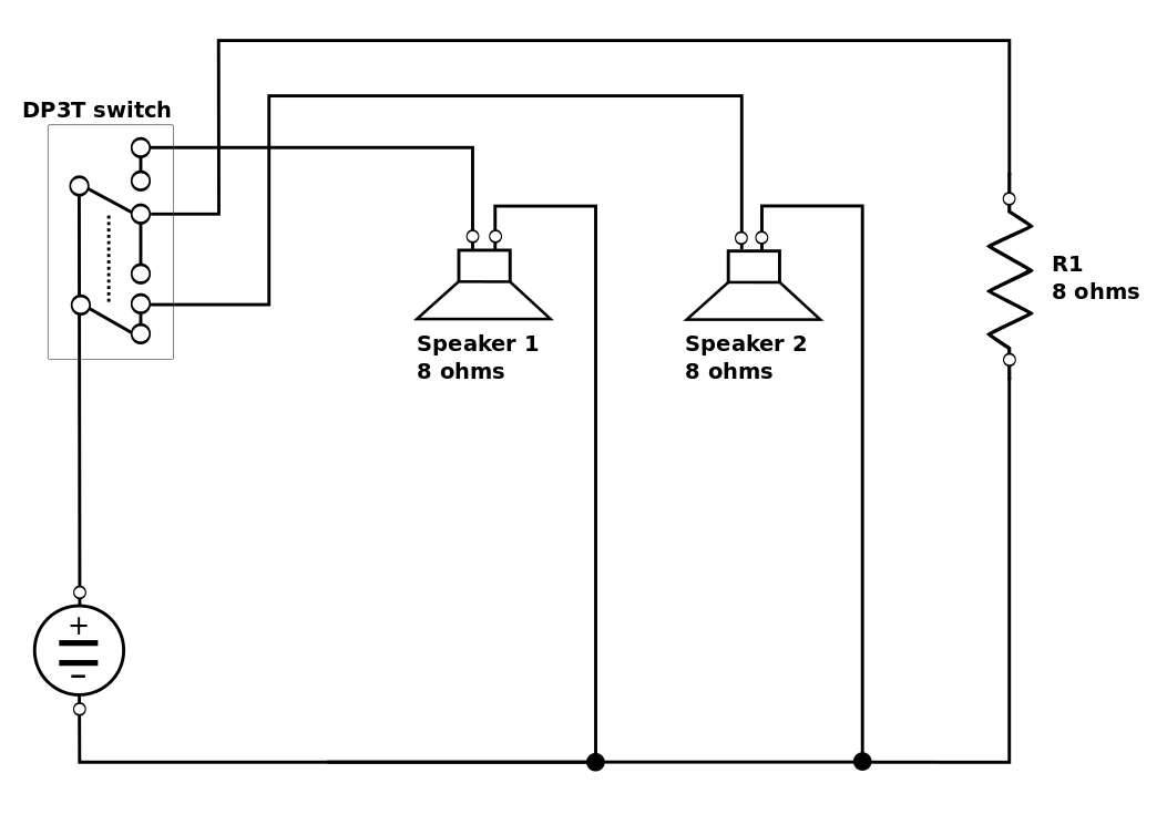

Hi all, thanks in advance for the time spent on helping me out on this project. I greatly appreciate! :)
Goal
To build a dual-channel, 2-way speaker switch to control the output from the hifi amplifier to 4 speakers, speaker set 1 and 2, that are located in two different rooms.
The idea is to be able to activate speakers set 1, 2 or 1+2.
The numbers
- Amplifier output: 70W + 70W (4 ohms at 1 kHz) DIN Power output. (As stated on the service manual)
I know this is fuzzy figure. The amp is an old Sony TA FE-370. For the sake of start designing, I have assumed this figure to be the constant output power from the amp, leaving headroom for possible spikes in power. As soon as I will receive a new multimeter, I will attempt a more detailed measurement of the output, choosing the final components accordingly.
- From those numbers, using Ohm's law, I derived volts and amperes:
P = 70 watts
R = 4 ohms
Output voltage = √P * R = √70 * 4 = 16.7 volts
Output current = √P / R = √70 / 4 = 4.18 amperes
- Total resistance of the parallel circuit:
Number of resistors = 2
Resistance = 8 ohms
Total resistance = resistance / number of resistors = 8 / 2 = 4 ohms
Design
Approach
The schematics above shows the design for a mono-channel switcher, which will be duplicated for the actual use (example is wired to Left channel).
Following the idea on this Wikipedia page, https://en.wikipedia.org/wiki/3-way_lamp, the DP3T switch controls the positions necessary to activate each set of speakers at one time, or both at the same time (1, 2 or 1+2).
A dummy load replaces one of the speakers when just the set of speakers 1 or 2 is working. This is in order to maintain the overall resistance constant.
Technical data for components
DP3T switch:
Contact Voltage AC Nom: 250V; Contact Voltage DC Nom: 28V; Contact Current Max: 5A;
Dummy load
Resistance: 8ohm; Power Rating: 50W; Resistance Tolerance: ± 1%;
Questions
1. I'd appreciate a general feedback on the design. Is it well designed? Is it gonna work? Any drawbacks you can think of, or possible improvements?
2. Given the numbers for current and voltage, would the circuit be safe to use as it is, once wired?
Thanks a lot, please feel free to ask for more details and/or slap the total newbie!
Michele
R!f@@
Joined Apr 2, 2009
10,005
Why do you need a dummy load ?
Dummy load wastes power.
Amplifier will run fine without the dummy you know
micheled
Joined Jun 21, 2015
10
Hi R!f@@, thanks for your reply.
But don't I need to keep the resistance constant when one set of speakers are not powered? I might be a bit slow here...
Thanks a lot!
R!f@@
Joined Apr 2, 2009
10,005
Nope.
Without a dummy you will be fine.
You showed a mono block, so I assume if you use stereo you would use two identical connections, if so you will be using both channels. No need for dummy.
If you use a mono one you will always be using one speaker so no need for dummy here too.
Dummy is used to test amps without destroying your hearing.
You will do fine with a relay of 5A, 30VDC contact rating. The coil voltage will be of your PSU choosing.. Mostly 12V~24V coil rating are used.
micheled
Joined Jun 21, 2015
10
Okay, Okay, got you. For some reasons I wanted to utilise the maximum power from the amp at 4 ohms no-matter-what, but in fact half of it would be totally wasted anyway on the dummy load. Thanks for pointing out a very basic thing... :)

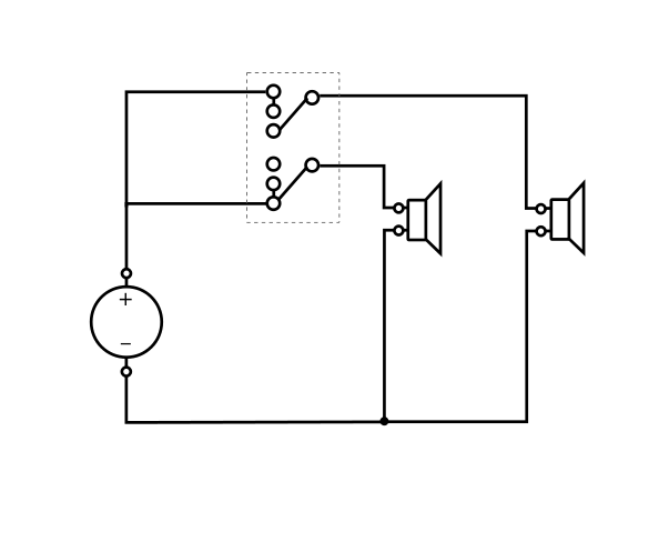

I realised that adding a relay as suggested above by R!f@@ could actually be counter-productive, if not planned properly. Spikes of power from the amp could trip the circuit, when actually these spikes are part of the normal operation of the amp as I think I read elsewhere. I redesigned the circuit (below) without any additional load, or safety measures. The last idea is part of the assumption that the amp has already got built in some form of protection from over-current, therefore making the addition of another relay possibly superfluous. Am I wrong here? Is this bad practice? Thanks, I know I've got a lot of questions, possibly banal ones, but I'm new to this :)
micheled
Joined Jun 21, 2015
10
- Switch in top position powers speaker 2
- Switch in middle position powers speaker 1
- Switch in bottom position powers speaker 1 and 2 in parallel
- This is a switch for one channel, actual switch will have two, Left and Right channels.
Edit:
I may see what you mean, just having a second, harder think about it.
#12
Joined Nov 30, 2010
18,224
I think you need a 2 pole, 3 position switch to do an A, B, A+B activity.
Works better (in my mind) with the wipers connected to the speakers.
#12
Joined Nov 30, 2010
18,224
Not what I said to do, but that is one of several configurations that will work. It reads out, A, A+B, B
ps, I only appear to be patient because you are not assuming I am secretly feeling hostile. Right now, I'm just quickly spewing out facts without emoticons because I have too many chores on my plate.
