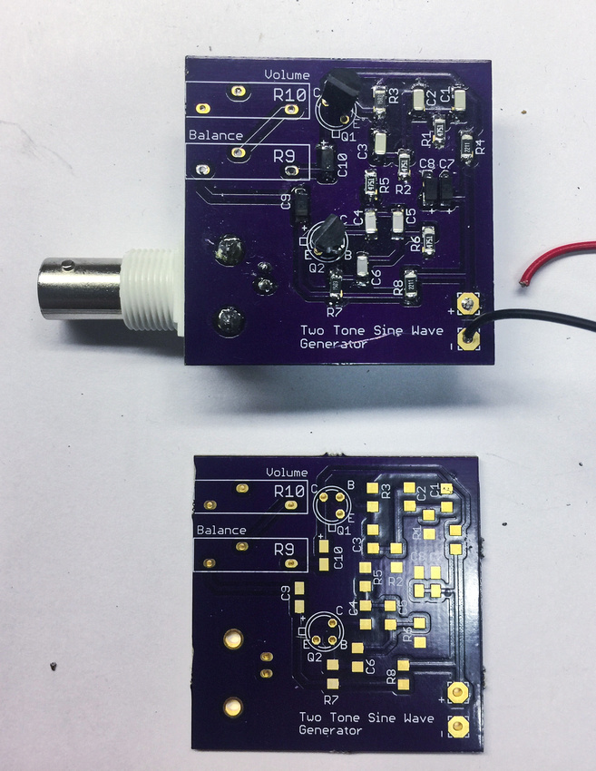

1st post - Troubleshooting a Phase Shift Oscillator
Mike6158

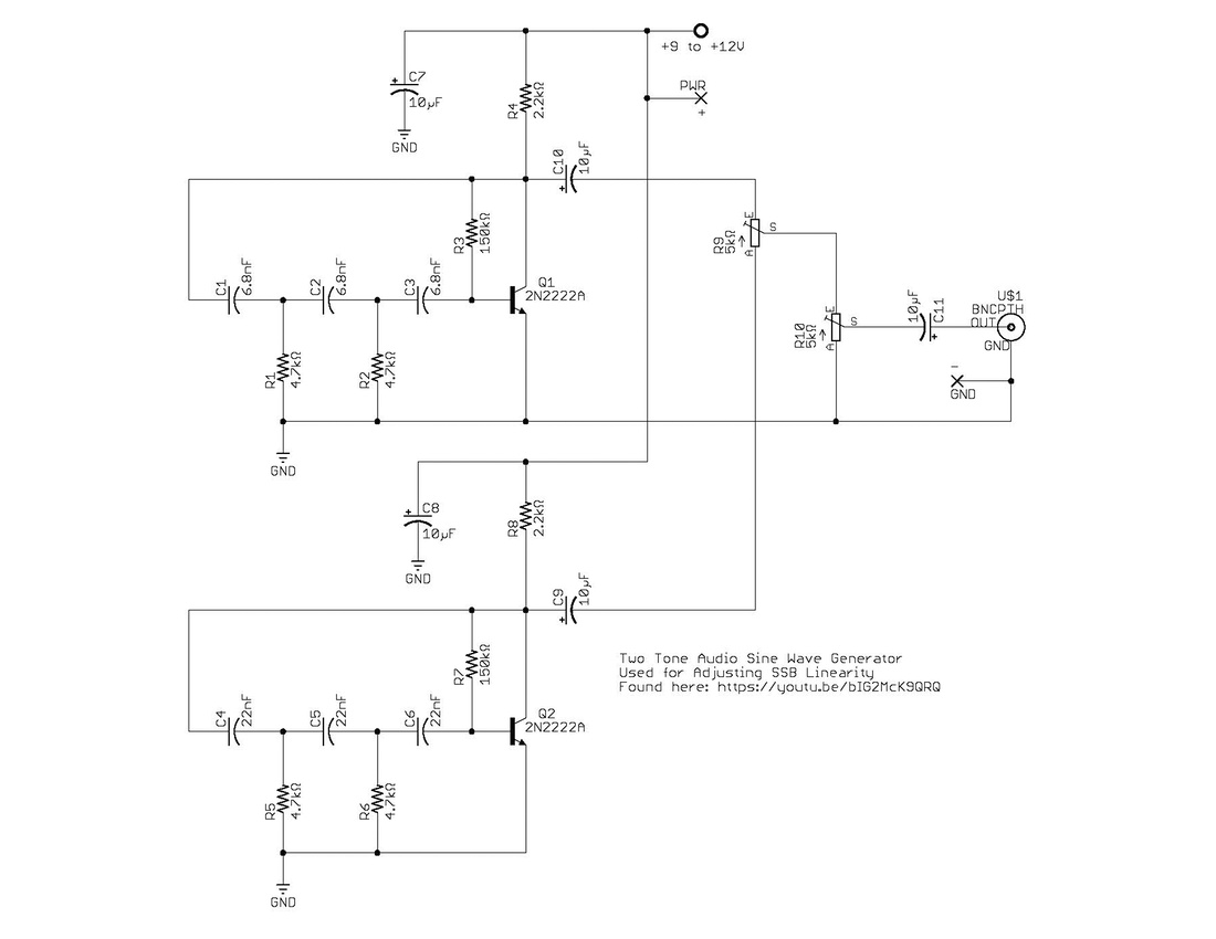

Prior to posting I did a little research and determined that each oscillator is a Common Emitter with Collector Feedback Bias circuit (unless it isn't :) )
I took some readings around Q1, R3, and R4.
Vcc = 9.0V
R3 = 150kΩ
R4 = 2.2kΩ
Collector Voltage 7.98V
Base to Emitter: 0.59V
Ie (if I did it right) is about 2mA

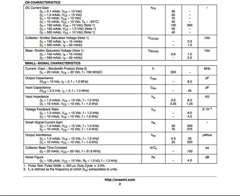

I used 100 for Hfe
That's about the end of what I could understand as far as checking the design goes. My intent was to try to analyze the oscillators by comparing actual to design but I have more ambition than I have knowledge.
The problem with the circuit is that it isn't oscillating. I've quadruple checked the components and they are correct. I've cross referenced my schematic with the author's schematic and they match. There are some idiosyncrasies with my Eagle schematic vs the original but they are the same for all intents and purposes. I had some boards made at Osh Park and I used surface mount components for all but the pots and the transistors so this isn't a stray capacitance / breadboard issue.
The transistors that I used are actually P2N2222A's. All other components are as noted. The circuit below is my Cadsoft Eagle version of the circuit located here:

Double check the lead identification of your P2N2222A transistors. These are different from 2N2222.
Post a photo of your board with components on it.

Those are phase shift oscillators. The output at R9 can vary due to phase shift between oscillators.
If you reference the oscillators together......R9 should be consistent.

Photos:
My boards
Bottom

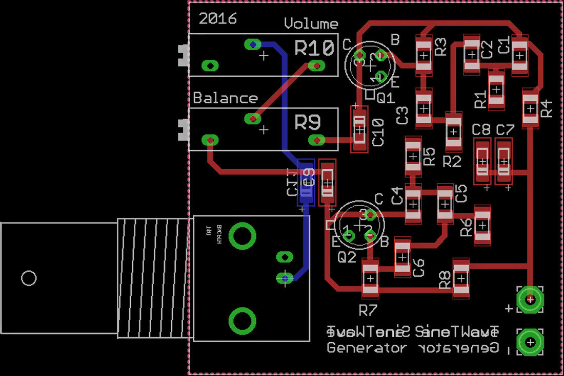

Board file from Eagle. If I do it over I'll rotate the BNC 90° CCW and move some of the components.
I got the Hfe from an On Semiconductor data sheet for the PN2222A.
I mistakenly wrote P2N2222A in the first post
More than likely I read the datasheet wrong but here it is anyway (and there's a link above)

The transistors are fitted incorrectly. Looking at the flat side with the legs downwards the order is E, B, C. On your board they fitted 180 degrees out so the emitter and collector are swapped.
Mike6158
Joined Jan 19, 2017
8
:( If I had a dollar for every time I looked at the transistor orientation I would have a lot of counterfeit dollars... How does one look at something like that so many times and not see it? I was all set to post a photo for you to see that they were installed right and they simply aren't. Thank you
I'll swap them and report back
Mike6158
Joined Jan 19, 2017
8
I didn't swap the transistors, I replaced them and installed them correctly. Poof... like magic... it works as it should. I don't know how I missed that they were in backwards. I looked dozens of times. Oh well... I have proven that transistors are not ambidextrous...

Personally I would either rotate the BNC, remote mount the BNC, and/or remote mount the pots if I made another one

Remove R3 and R7 from collectors......connect to power rail. Put them sorta in parallel to R4 and R8.
Re: moving resistors
I say leave them where they are. The design works just as it is shown. Building each circuit individually (one step at a time) the oscillator works. The only changes I made was using a 2N3904 and running from +10 V.
Next step I will add the second oscillator, then connect them together.
But if I move the resistor as suggested it doesn't oscillate.
(edited to add ...)
Took a nap. Finished building the rest of the circuit. Works fine. One pot selects how much of each signal is selected. The other is total volume control. I can't tell what it sounds like. I don't have an audio amplifier on my breadboard, but I can see the waveforms.
