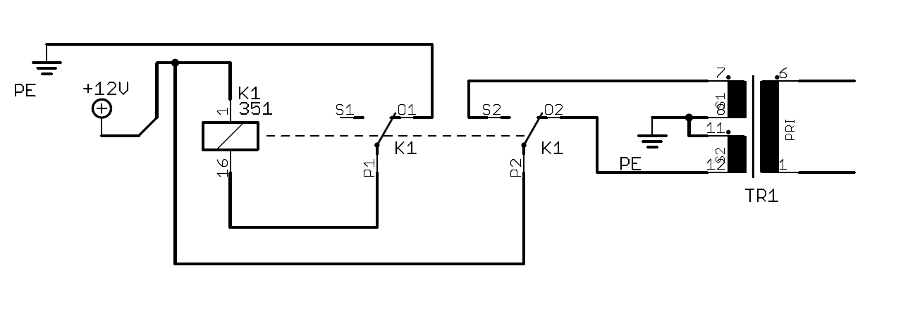

here ya go. the basic mechanical vibrator.
The power is connected to the normally open pins.(they are closed when the relay coil has no power). The power energizes the coil and the contacts move. This DE-energizes the relay and it releases, then the cycle repeats. This will be VERY hard on the relay and it will not last long. Specially designed vibrators that are more robust were built to perform this function for battery powered equipment which used vacuum tubes.
The output is sent into a dual winding secondary(or center tapped one) and the transformer steps up the square wave AC voltage. The output from the primary will be a high voltage AC waveform and must then be rectified and filtered to give a DC voltage. Those parts have not been drawn in.

Google 'boost converter'. There are umpteen schematics and explanations out there.
