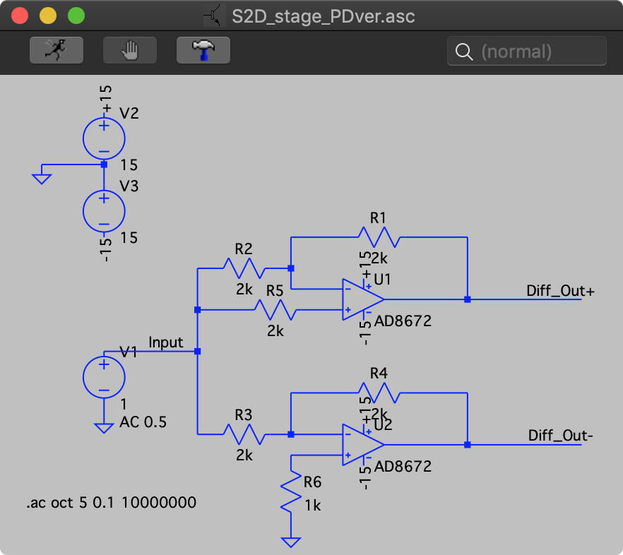

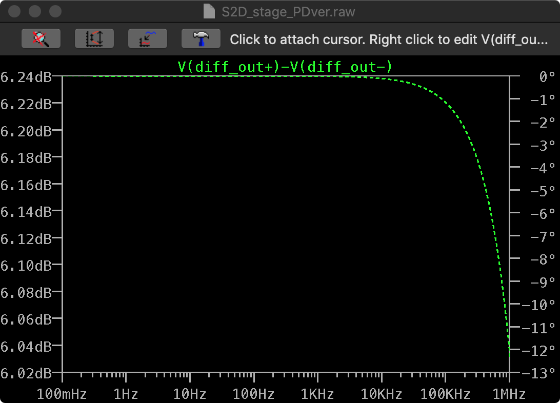

Once you have some draft or prototype circuits, it’s a good idea to perform some SPICE analysis so that you can find the bugs of your circuit before you make the physical board. A powerful and free SPICE software is called LTspice.
LTspice — simulating circuit's behavior, an ac simulation gives you the frequency response of the circuit.Packages / Footprints

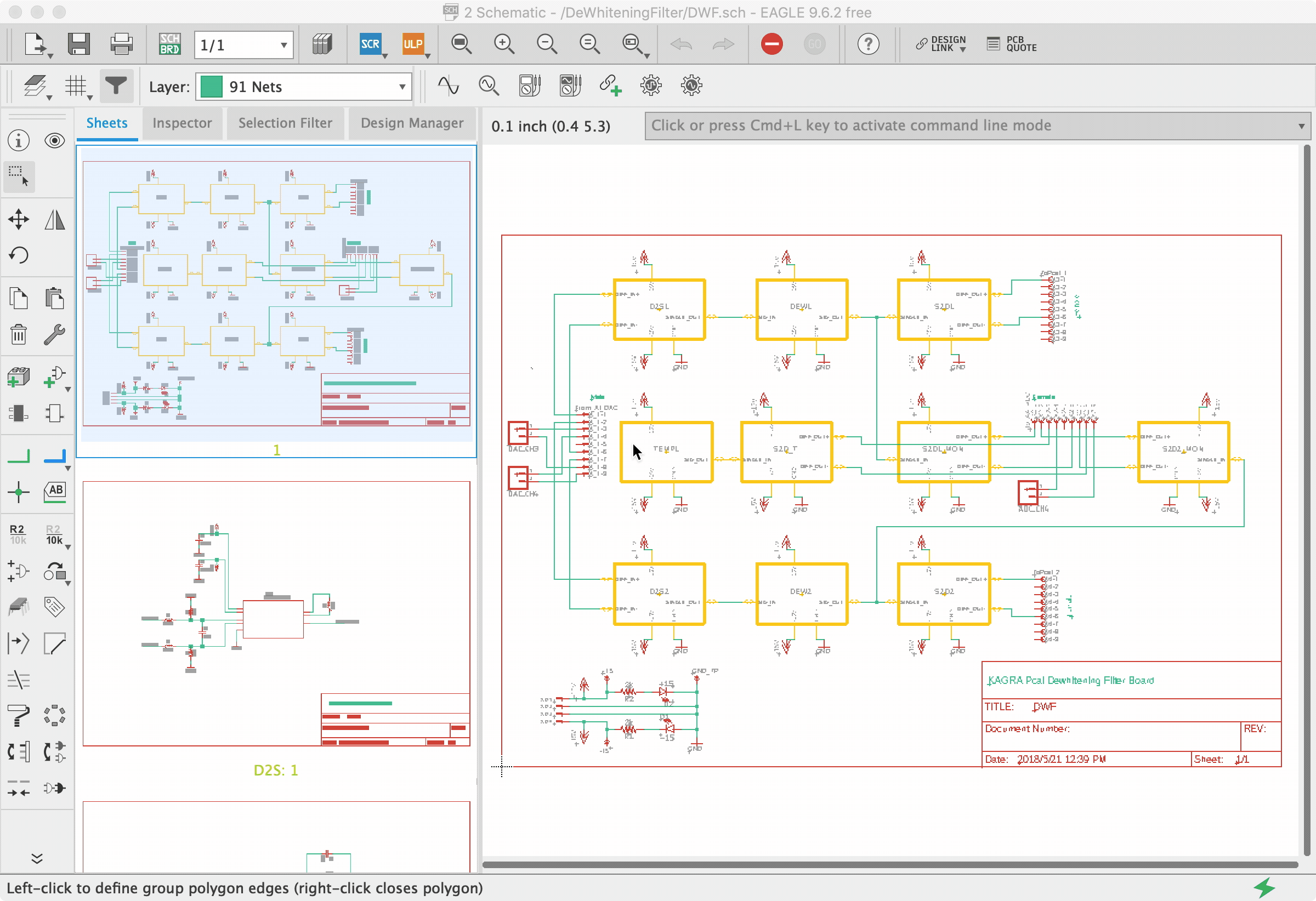

Then, you can draw the circuit diagram by using PCB design software in its Schematic View. At this stage, you have to decide the package of each component because the software will generate all the pads in the Board (Layout) View according to your circuit design, and it has to aware of what kind of pad (size) it should put on the layout. About the packages, usually, they are divided into two categories, Through-hole and SMD (Surface Mount Device). If there is no special requirement, SMD is preferred nowadays. Here is a nice review comparing the Through-hole device and SMD.

Eagle (PCB Designer) — Schematic (Circuit Diagram) View

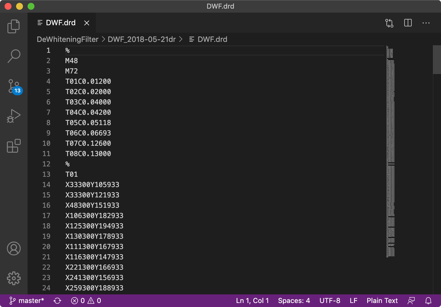

NC Drill File and Gerber Files

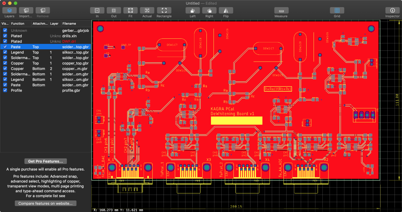

Once you finished the layout, it’s time to export your work to the files that can be sent to the PCB manufacturers. In the industry, people use the Gerber Files, a vector image format, for making PCB layout and use NC Drill File for Vias and holes to be drilled on the PCB. When you export to the Gerber, you will find the software gives you about ten files corresponding to different layers in your PCB, including Copper, Soldermask (the green polymer preventing solder bridges), Silkscreen (white text and indicators for human) for both top and bottom… All of them are Gerber files. Different software gives you Gerber files with different extensions, but they are the same things. You may also check the Gerber files you exported by Geber Viewer like Cupru‪m‬ on macOS.
Cupru‪m‬ (Gerber Viewer) — Viewing Gerber files generated by Eagle
Content of NC drill file

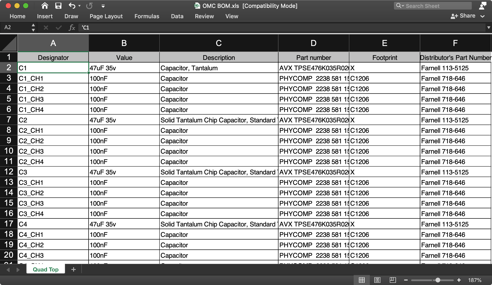

After you submit your Gerber files and NC drill file to a PCB manufacturer, it is time to worry about purchasing electrical parts for PCB assembly (soldering). Usually, we will export a table called the BOM (Bill of Materials) file. It contains the name of each part on your PCB and its part number… This BOM file can help us ordering parts from Digikey or Mouser. Also, when we solder the components onto our PCB, we can refer to this BOM to know which parts should be soldered onto which place. If you want to send your PCB and electrical parts to a PCB assembly factory for automatic assembly, you also need to provide this BOM to them.
Example BOM file source:https://dcc.ligo.org/LIGO-D1003116/public

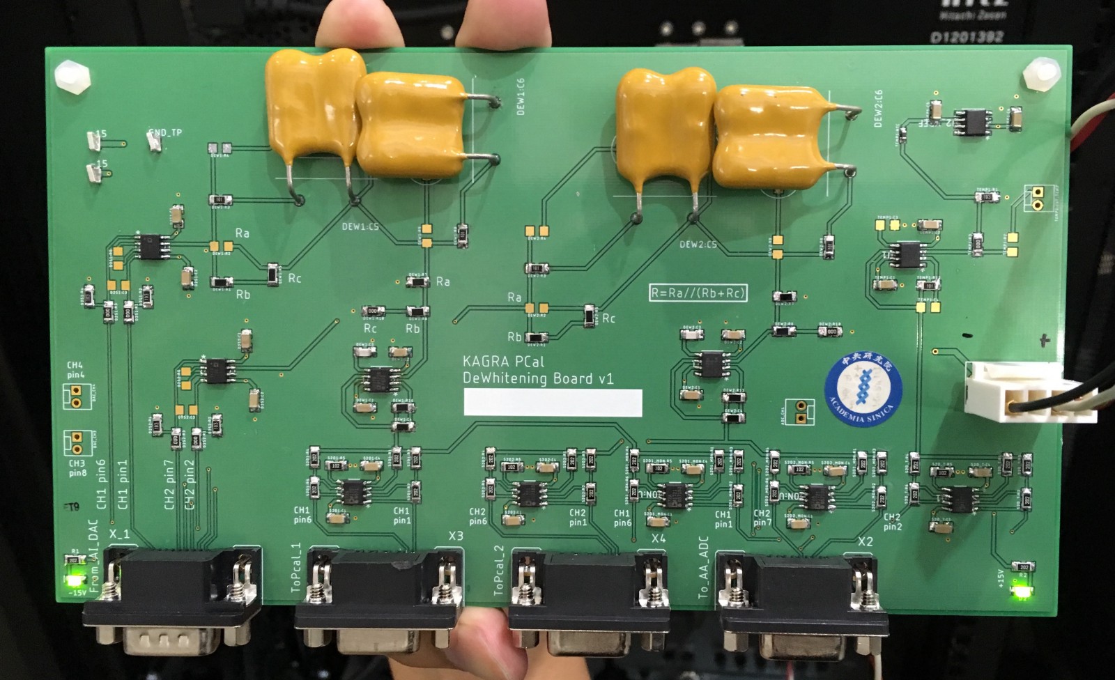

After you received your PCB from the manufacturer, it’s time to solder the electrical parts onto it. Let’s discuss something about soldering.
