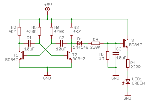

I think ive found a reasonable solution. I could use a multivibrator circuit rather than a 555. After a little searching i actually found something that supposedly will do exactly what i want; https://www.axiris.eu/en/index.php/project-corner/breathing-led
All ill need do is see if i can lower the supply voltage to say 3.3v, then adjust the component values as required. I'll have a simulation when i get home and maybe build a test circuit if i have the right values kicking about.

I'm not overly familiar with MCU's other than tinkering with an arduino.
Would something like the PIC10F be a the right sort of ballpark?
DickCappels
Joined Aug 21, 2008
10,661
A PIC10F would be an excellent solution. You only need to add a power supply decoupling capacitor and a current limiting resistor for the LED. I've done something similar with the Atmel ATTINY12, and it was pretty easy.
