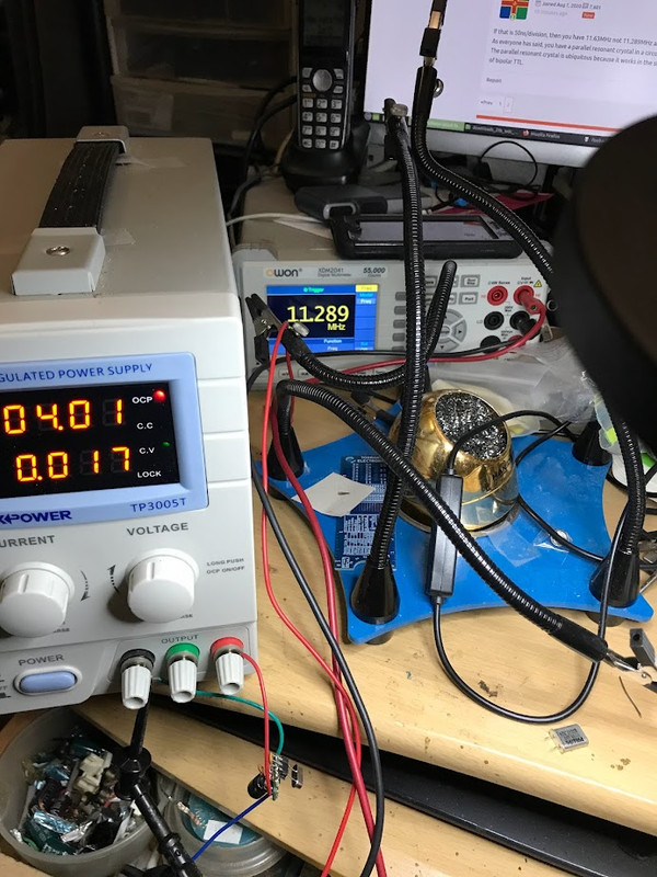

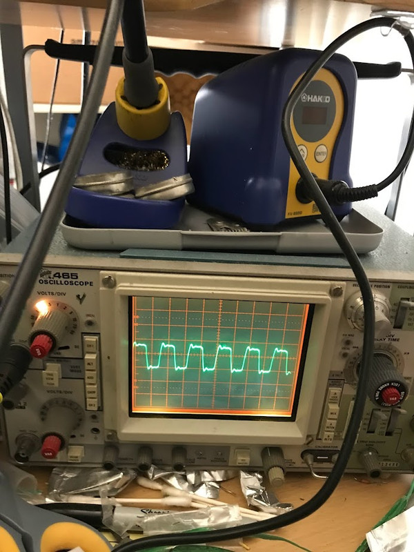

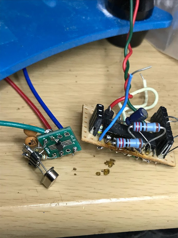

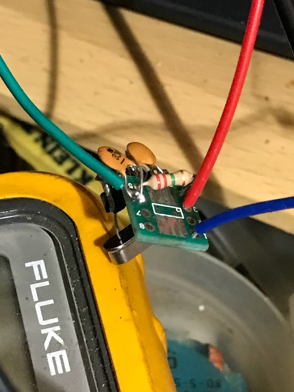

Bit disappointed that this exchange led to confusion. Guys, I can't really make much sense of your suggestions, so I decided to follow my orig gut and go with an "intestinal" flatulence . I did note it here:
https://forum.allaboutcircuits.com/...al-ckts-11-289-mhz-needed.194299/post-1828042
"It's a gas!!"
I.e., it works well, especially if one buffers the output with a decent 100R. I may experiment with squaring it up further with an 74LS04.
Photos of this project below... (in the 3rd photo, the project on the right is the earlier, unsuccessful attempt, also shown in TS post 1 of this thread)

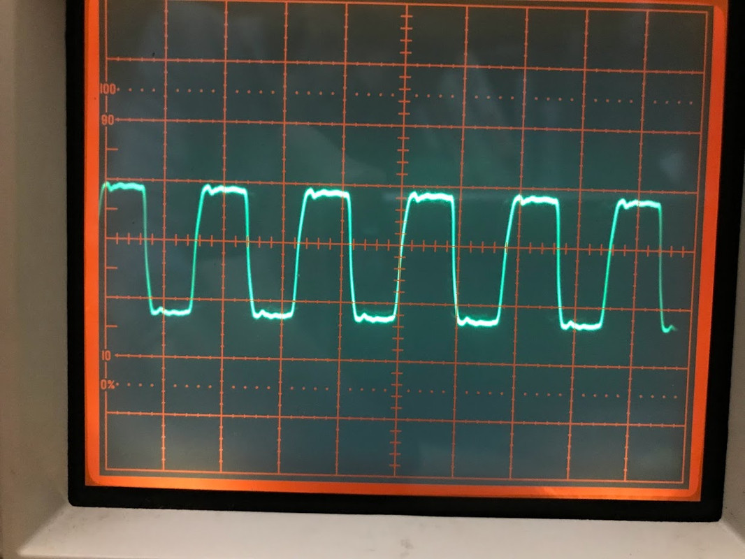

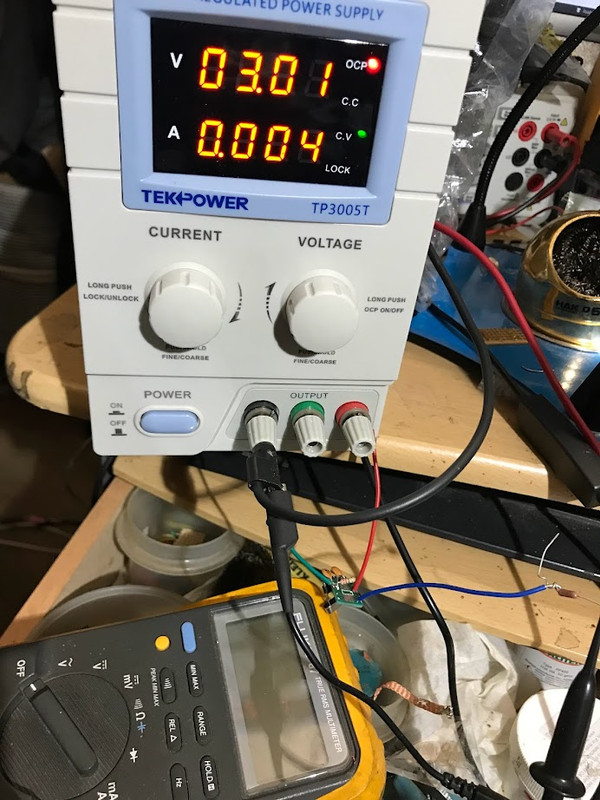

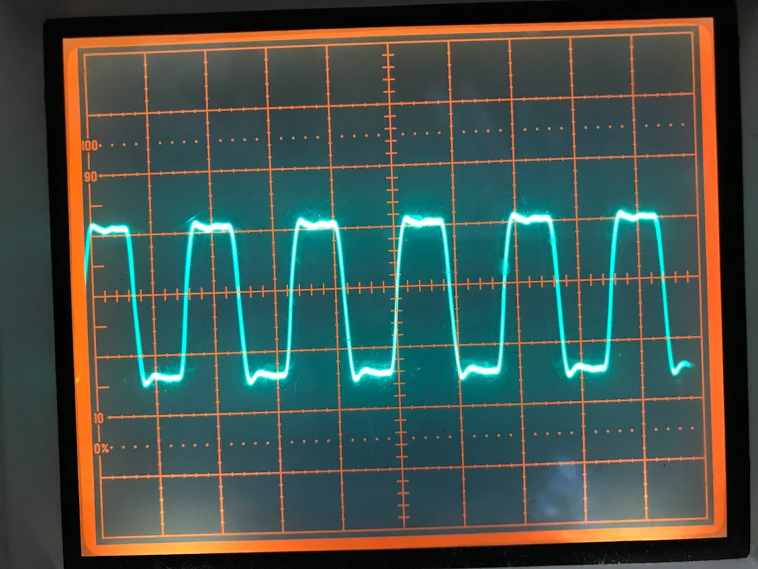

13hm13
Joined Jun 1, 2023
75
An update, with squaring up ... added a Panasonic 100uF/50v FM cap on Vcc/GND pins of driver. This improved output waveform. Also plugged in a Philips 11.289 xtal (1989 vintage) that gave very minor improvement over the smaller (new) generic brand. Finally compared to Martin Clark Flea regulator (an audiophile clock; note waveform is a but taller because of 5v input voltage).
1: Philips 11.289 xtal (1988 vintage); 4.00 Vdc
2: Generic 11.289 xtal (2023, new); 4.00 Vdc
3. Martin Clark Flea "Audiophile" reg with Vanguard 11.289mhz low-jitter osc. 5.00Vdc. (Uggghhhhh!! Note geometry of vertical sides are not as steep and some added ringing, compared to the cleaner, "squarer" teeny-tiny SN74LVC1G04-based 4.00 vdc design. Now what does really constitute a "sound" design for audio ??? .... ahem .... )
Ian0
Joined Aug 7, 2020
13,286
If that is 50ns/division, then you have 11.63MHz not 11.289MHz and your music will be a semitone sharp.
As everyone has said, you have a parallel resonant crystal in a circuit designed for a series resonant crystal.
The parallel resonant crystal is ubiquitous because it works in the single-gate Pierce oscillator circuit. The series resonant circuit went out with the demise of bipolar TTL.

Ian0
Joined Aug 7, 2020
13,286
Your scope needs calibration.
8.6 divisions at 50ns/division for 5 complete waveforms = 430ns total, 86ns per cycle = 11.63 MHz.
was I supposed to tell from that jumble of wires which circuit you were using?
13hm13
Joined Jun 1, 2023
75
Dude ... it's an old Tek 465 'scope from 1976. No one asked you (expected you!) to go off in a pointless diversionary tangent and pursue freq specifics based on the waveform. The purpose was to show the squareness of the waveform, which the old analog 'scope can do very well.
I could have easily shown you a direct image capture from my Siglent DSO. But that's not what this thread is about.
Stay on topic ... please!
