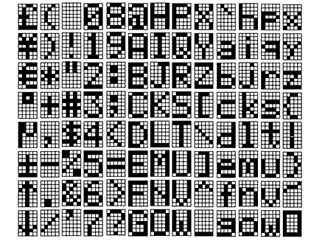

    In a graphic display the display characters are "normally" stored in n x n bit mapped
    font in memory. So take for example a 5 x 7
    [​IMG]
    This is bit packed into memory different ways, but with a logical
    ordering, such that you can retrieve row by row or col by col
    the data to output to display. Usually done in C by using pointers.
    That's oversimplification, but is really a very basic operation of
    reading the characters data by row or col and, then outputing that
    to either a display buffer or display memory.
    Of course on display side you keep track of where you are writing
    in its memory. Usually a good practice is to clear the region you are
    going to use, then doing the writes.
