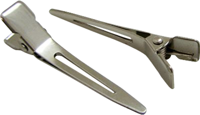

I'm in the middle of a project of upgrading one of my guitars. The next thing I have to do is solder all of the electronics together. What I need to know is where and to what components I need to attach my copper alligator clips to draw the heat away from the components to prevent damage to everything.

A big part of the answer is to use good technique in the first place so that heat sinking is less of an issue. Hot, cleaned and tinned iron, proper solder, a holder perhaps to hold things together well. Good lighting and maybe a magnifying glass to help you see.

A long time ago when transistors were made from germanium before silicon transistors came along, it was common practice to heat sink the leads while soldering. I used my sisters' hair styling clips to do this.
Those days are long gone.
Proper soldering equipment and technique is what is required.

I have plain, non-insulated copper alligator clips that I bought from StewMac to work with. I would've never thought of using my wife's hair clips! I'm learning something new everyday!

Copper alligator clips are much better heatsinks. Steel has dismal thermal conductivity in comparison. Most stainless steels are even worse.
Before I quit doing electronics I might have used a heatsink for an average about 1 joint in a few thousand - and that most likely on something where I didn't want to re-melt an existing joint near a new one I was making or I was doing something oddball. There are components that do require care to avoid excessive heat, often because the packaging material won't take it. With surface mount components, everything is heated up to the melting point of solder, though pretty accurately controlled in both time and temperature.

Nothing you've mentioned here would cause me to take extraordinary measures (applying clips) while soldering. Since you have the clips ready to go, I suppose it makes sense to use them on the expensive pickups . But as long as your technique is working (making a clean solder joint in ~2? seconds or less), I wouldn't sweat it. Use them where it's easy, if you want. I've built a few PCBs with ICs and transistors and such and didn't heatsink any of them.
