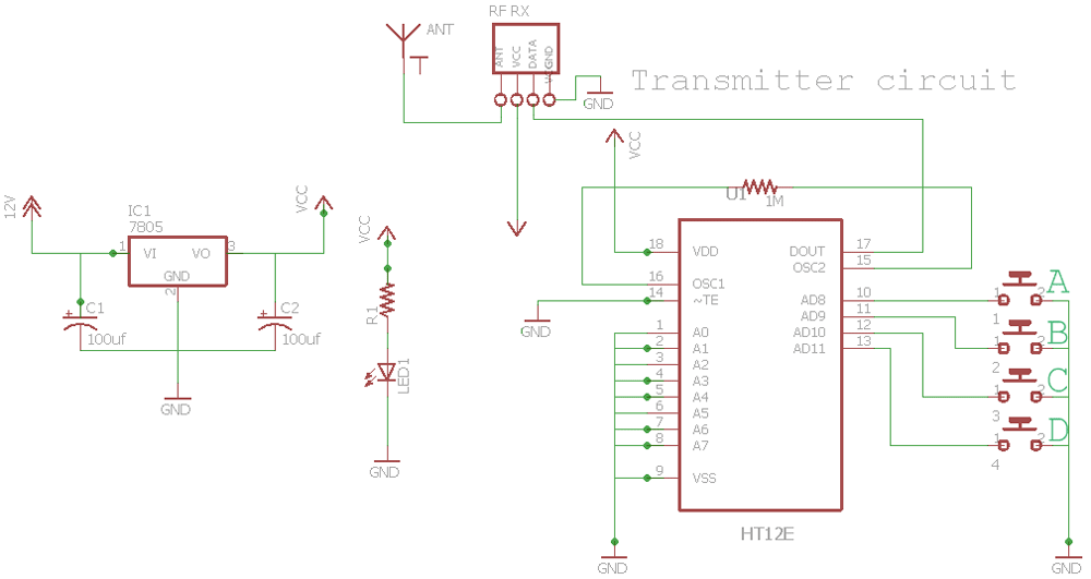

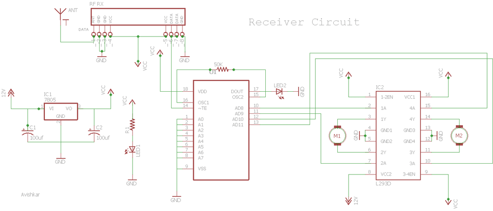

So I have this project(RC Multipurpose planter with solar panel) for my final year in mechanical engineering, and i have been researching on electronic schematic diagrams. I don't have much knowledge on making circuit diagrams so i searched for one.
And this is what i have found, a simple and small diy remote controlled robot schematic diagrams. (See site and pics)
(Credits to the publisher)
https://diyhacking.com/remote-control-car/
Transmitter Circuit:
Receiver Circuit:
It is relatively simple and easy to build. I think this is gonna work for my project.

Hello,
The given L293 will work upto 1 A, so 12 Watts @ 12 Volts.
If you want to use larger motors, you must choose an other driver.
Bertus

A little thoughts about the project.
The first task is to find another motor control circuit. L293D is a maximum of 0.6 amps per motor.
Immediately, I believe that it is something with an IC with four external MOS transistors per motor. These driver ICs should also have an over current limitation.
Additionally, I am a bit worried about starting two 40 Wats motors at full power, some ramping of the motor power, both at start and stop should also be considered.
I see many projects using this outdated chip. Don't really understand why. Guess it's like the LM741 opamp, so outdated but will never go away. and the manufacturers won't stop making them on there own because they still sell and the tooling has paid for its self.
Many people don't know there is and has been a higher power substitute for it, the SN754410.

Anyways, If i change my motor to 36V, is this feasible? im gonna lower power to 36W(And so lose speed) But is it feasible?
djsfantasi
Joined Apr 11, 2010
9,237
Can i use this motor driver(MC33926)? How do i replace this from l293d?
https://www.pololu.com/file/download/MC33926.pdf?file_id=0J233
Earlier you stated two factors influencing you design. Your motors are 12VDC motors. And secondly, they draw 40W and I am assuming each.
That means according to the definition of Watts, that each motor is going to draw 3.3A. Times two is 6.6A. The recommended maximum current draw of the 33926 is 5A. You are over. Even if you weren't, it is too close to the max. You need some headroom.
Of course, if you are using two drivers, you'll be ok if it is heat sinked properly.
Do you know the stall current of the motors? That is what you need to size your driver for. It may be more than the calculated value given the stated Watts.
