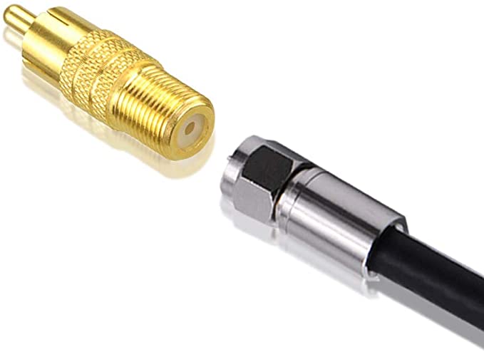

Not cheap? 2 gold plated parts for $5 or a bag of 10 without gold for $5? Sorry, that's a level of poverty I haven't been exposed to before. You have my respect.

Those "F" connectors are not cheap in small quantities, and I have not seen the others at that price around here, at least, in quite a while.
And it seems that what is "cheap" varies quite a bit among us. I am aware that the cable company buys them by the thousands, but I do not.

The link was Amazon, Buddy. No multi-dozen or thousands order there.

I got some F connectors on eBay a couple years ago like I remember from the 60s. Just a machined nut and an inner part that slid down between the braid and the outer insulation, maybe a C-ring to hold it in place. They always worked adequately, we used to squirt them full of silicon grease if they were going outdoors, and snugged them up with a (7/16?) wrench. Something like 20 cents each. They were strictly for RG-59. No gold plating, which is only good if the mating parts are gold plated..
RCA plugs are hard to find in the old style too. Every TV chassis had a chunk of coax coming up from the IF strip with a soldered-on RCA plug that plugged into the tuner. They were so standard there were tuner substitution boxes, I think a solid state tuner with a 9 volt battery or two. I always cut those off and saved them before the TV went to the dump. Very simple, a hollow pin you soldered the coax center lead into, a bakelight insulator, outer tabs that were just bent sheet metal. With much use you'd need to give the tabs a squeeze with piers ("retension") or the ground connection would be flaky. Aliexpress is maybe the wrong place to look, I'd settle for some new old stock American ones from eBay, but I wouldn't spend much over 20 cents for those either.
