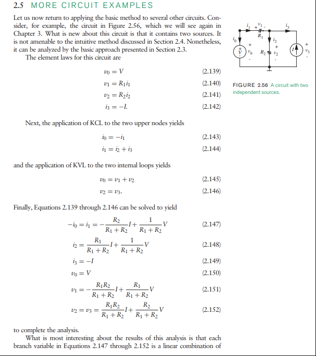

I can't comprehend how did this example reach equation (2.147). The first part which is -R2/(R1+R2)I is pretty easy and straightforward, it's just a current divider formula for I. The second part looks like a voltage divider formula, but the resistors are connected in parallel, how is voltage division applicable in this case?
WBahn
Joined Mar 31, 2012
33,324
While the first term is the current divider equation for I, notice that it is NOT what you might expect because it ignores the influence of V1. The current divider formula assumes that the two resistors are in parallel and these two are not. However, IF you turn the voltage source off (i.e., set its output voltage to zero so that it behaves like a short circuit), now they ARE in parallel. The leading minus sign comes from the fact that we want i1, which is defined in the opposite direction as the current from the current source.
As for the second term, it is NOT a voltage divider formula at all, in any way, shape, or form. Look at the units. It is a voltage divided by a resistance, which is a current. What if we turn the current source off (i.e., set its current output to zero so that it behaves like an open circuit)? Now that formula is the current i1.
So the first term is the current i1 due solely to the current source while the second term is the current i1 due solely to the voltage source.
As for where 2.147 comes from, the line above it gives the big hint -- you need to take all eight equations above it and manipulate them to get a solution in terms of the knowns and then manipulate that to separate that equation into terms involving each of the independent sources.
Take your best shot at doing that and post your work, we can then help you overcome whatever hurdles you come up against.
