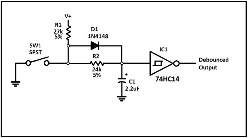

Yes Ceramic or Mylar will do, around 100nF .
Polyester would be another choice for de-bouncing, The capacitance is well controlled. +-5% is common.
Use tantalums. As you observed, they are much prettier and come in a variety of colors. Now for your resistors, have you considered tantalums too?
Accuracy matters when and where it counts. It hardly matters in a switch debounce circuit.
MrChips, YOU'RE TOTALLY RIGHT! that is in brief what my problem is all about! My pedometer circuit alike works with 50% counting error, and sometimes more! Below are the sensor motion switches that I tried so far beside a couple more types. Once I feel that I found the right capacitor value I notice that my sensor switch is bouncing 10 times per second. So, I try to go up with the cap value, which it does fixes the bouncing issue, but the down side is it delays counting because it works against the sensitivity of the switch, unless you start jumping so that you shake the switch crazily and your ckt start counting. It is such a pain! Thats why I was trying to try different types of caps, I thought this might fix the issue, because I cant really find a good stable bouncing sensor switch.

Granted, you do not always have the liberty to select a SPDT switch.
If the switch is SPST, then you have to settle for less ideal solutions using capacitors and Schmitt trigger.
This is only one example:

But the price for this piece only is around $100! My whole circuit now doesn't cost more than $5.
Duh! That's the price for a complete sensor development board. This is what you should be looking at. Only $6.50 for the sensor itself.
However, if that's still too expensive and you'd rather use a simple tilt switch or similar, get rid of that screwball circuit you showed and use the one @MrChips gave in post #29. It'll work a LOT better.

The best way to debounce a pushbutton is to use a SPDT switch.
The actual implementation will depend on the logic IC family.
I'm not sure if was able to explain myself well here, my poor ESL English :( ! The way I'm using the sensor switch in my circuit is as show in this new image. And it should start counting/triggering based on the body movement/motion, therefore I'm not sure how I'm gonna use this non-sensing SPDT switch! I want it to click while I move!

Look at the next post, #29.
MrChips & OBW0549,
Thanks a lot for your assistance! I will build this additional circuit and let you know!
OBW0549, yes, $6.50 still too much and I love my screwball circuit and just attach MrChips' ckt to it :cool::D
