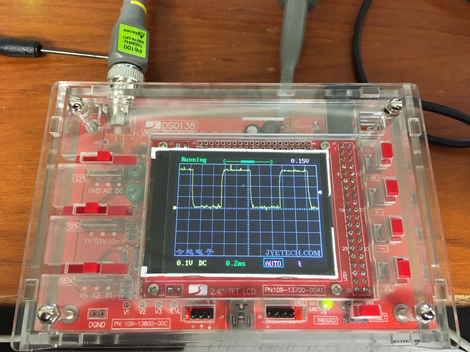

I've got this el cheapo DSO coming. I don't know how useful that will be. And a frequency counter? O.K. I'll look into that.

No It's not the same And something has gone wrong. When I go to view the order I see a message from ebay about having to remove the listing and the seller no longer being part of ebay etc...
And when I look at my order record it occurred to me that maybe I've bought only a shell to put a circuit board inside? Even if it does turn up.
Even if I've been ripped off it doesn't much matter. For $9.
I'm interested ot know of any 'reviews' or accounts of experiences with these things...
hmmm I googled a bit and it seems the dso150 is a kit - as you probably already know - and they sell shells for them and there's bodgie sellers around. It looks to me like my sale was truly advertised as the kit + shell but I imagine I'll only get one or the other when the order turns up. IF it turns up.
That'd put me in the market for something else. Keen to receive suggestions. :)
