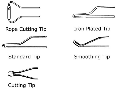

The got so many different tips for these units. Rope cutting tip, spade tip.......
http://ecx.images-amazon.com/images/I/41WLj7z9mYL.jpg
