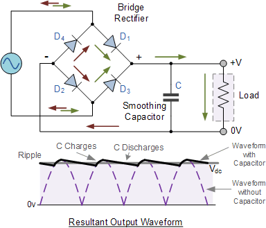

I looked at your drawings both of which show a transformer in the circuit. I believe I tried a 1:1 transformer without a center tap and still only got a half wave. However what I am ultimately trying to do is put mains voltage through a full wave bridge rectifier and convert it to DC. Can't get full wave with that.
(1) Without a transformer your circuit could KILL you! Be aware that transformerless supplies are a banned topic here, according to the Terms of Service. (2) If your bridge rectifier doesn't give full wave rectification it is either dead or incorrectly wired.

Then you are doing something wrong.
Take a transformer secondary winding with no center tap. Connect to a bridge rectifier. The output is full wave rectified signal measured across the bridge.
