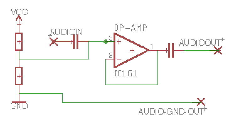

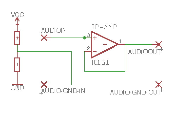

I've got a new question on theory.
I solved my problem by using an equal-resistor voltage divider and using that as my audio ground reference.
The other suggestion was to bias my actual audio signal.
What are the advantages / disadvantages to either way, and why might I choose biasing the input vs splitting the rail and getting ground from there?
The one benefit I see, is by simply splitting the rail, I didn't have to use many more parts.
Audioguru
Joined Dec 20, 2007
11,248
You want the input and output to be able to swing equally up and down.
Then you bias the input at half the supply voltage and use input and output coupling capacitors that pass AC but block DC, or use a plus and minus power supply and bias the input at 0V.

Then you bias the input at half the supply voltage ... or use a plus and minus power supply and bias the input at 0V
What is the difference here? When I have split the power supply using identical resistors, and used that reference as ground for my audio path, which of your methods am I using?
I ask because you say 'bias the input' in both cases, but I'm not doing anything to my input that I'm aware of, I'm simply using the divided voltage as ground.
I'm trying to educate myself so please forgive my lack of understanding.
Here's my circuit - I realise I don't have caps on there. I will add them and it seems to work ok without them - just providing the schematic to explain myself clearer.
Is the following what you are suggesting?
eljeffe
Joined Sep 28, 2017
39
Very clear - I'll have to try that.
Thank you!
Anything wrong with how I'm doing it now? Using the single power supply and splitting the rail for ground?
(not counting the missing caps, I know I need those)

You should never split the ground because many audio devices have the same ground which will short your split ground.
I think I get it.
So what you're saying is, it works for me in this very basic circuit, but in a real-world application, biasing the input is the proper way to do this.
And I think I get it now - the voltages are additive, so the DC bias + my input AC = my biased voltage.
Audioguru
Joined Dec 20, 2007
11,248
The input bias voltage is half the supply voltage so that the output can swing equally up and down. The input signal modulates the input bias voltage up and down.

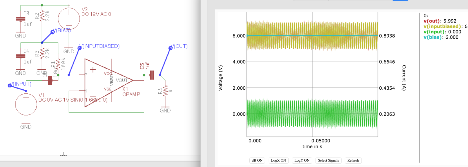

So I've laid out your circuit in eagle, and I'm trying to use the built-in spice simulator (ngspice) to look at the circuit.
From what I can tell, I'm not blocking the DC again at the output. I thought just a coupling cap like I have would work.
Why is my DC still present in the output?
(It's hard to see, but the output signal closely follows the input-biased signal up around 6v)
eljeffe
Joined Sep 28, 2017
39
Well it must have been a glitch in my layout - like the cap was acting as a jumper.
I've deleted and re-added the output filter cap, adjusted a few values, and now I'm getting the results I expect.
(I was using the 8ohm res to simulate a speaker, but I've since changed it to a 10k resistor and that really helped).
Thanks for all the help - and especially for taking the time to draw that circuit. Sincerely appreciated.
