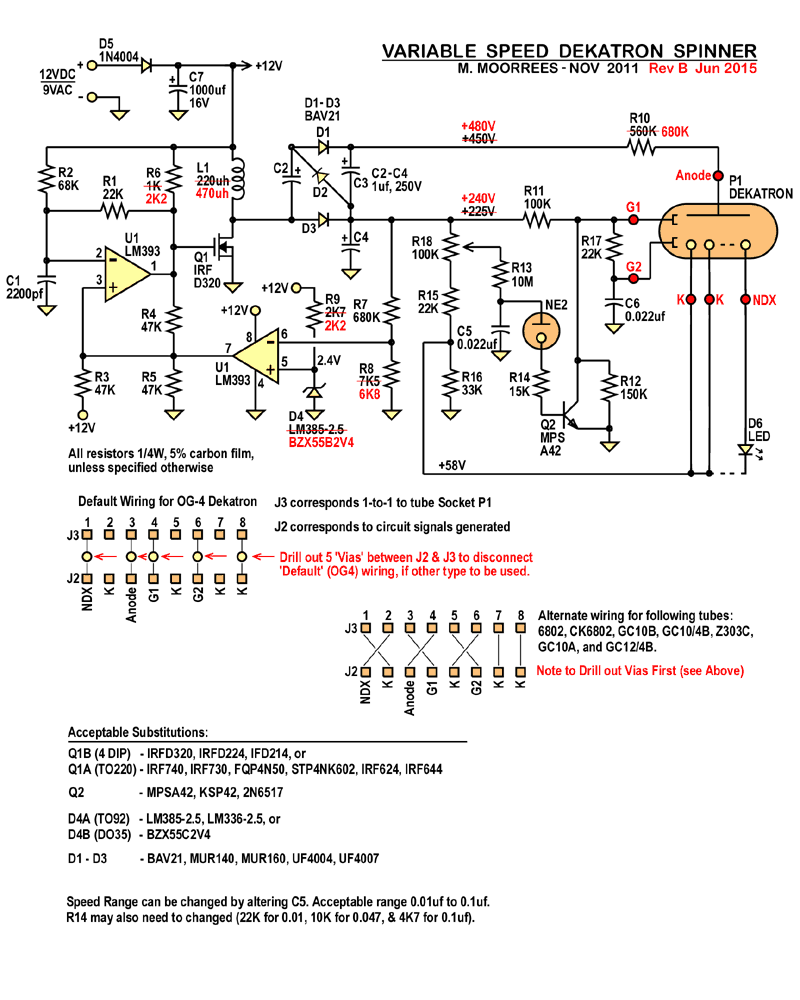

I've used this circuit many times. For one, its not an op amp. The LM393 is a dual voltage comparator. The difference between a voltage comparator, and an op amp, is that the output is open collector, and there is no frequency compensation, so it can oscillate at much higher frequencies. That's the simplistic version of the differences. Also why the 4.7K resisistors (4K7) are needed.
The top half of the circuit is an oscillator. To make your simulation work, add a resistor, say 150K between pin 2 and V+. This shouldn't be needed in the real circuit, but simulators are picky. The divider formed by the three 47K resistors make a node that bounces between 1/3V+ to 2/3V+. The other 47K connected to the 0.01uf cap, and pin 2, rise and fall at a delayed rate determined by their values. If the output is high, then pin 2 slowly rises to 2/3V+. At this point it causes the output to go zero. Pin 3 now has 1/3V+, and the pin 2 slowly falls until it just drops below 1/3V+, when the output, now goes high, and pin 3 steps up to 2/3V+, and the cycle repeats.
The lower portion, is a basic comparator. Depending on where the pot is set, determines where the sawtooth crosses its set voltage. That determines if the output is high or low. If the pot is set low, the sawtooth only sips below it for a short duration, and you get a narrow output pulse. In the middle, and you get a near 50% duty cycle pulse. Cranked full up, and the pot voltage is always greater than the sawtooth, and the output is always high.
There is way too much dependence on simulations. I use LTSpice from time to time, but there's no real substitute to just wiring the thing up.
Been selling the kit, below, since 2011. It uses that LM393 oscillator for its boost converter, generating 450V !
A dual op amp will fail in this circuit on the two points, I indicated for the differences. A open collector output is required, and most op amps are too slow.
