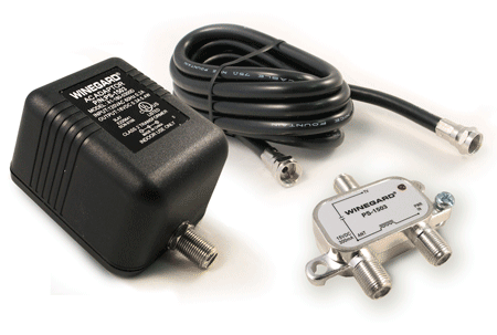

Here is the original setup (Winegard)
Right now, I have the wires from 9V PS twisted together with the stripped end of a piece of RG-6, and then onto the splitter ..Originally the voltage was applied through the F connector along the length of Coax. I think I have a barrier strip around ...solder for sure ..

If you want to get fancy, you could solder the 9V wires to an F-female connector (cannibalize it from the broken supply) and then use the coax cable to make the connection to the splitter.
