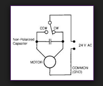

My gate uses a single phase, 120 V AC motor with a capacitor. It has 3 wires that I refer to as:
1- ground
2- forward direction
3- reverse direction
When there is power between 1&2 the motor rotates in one direction and when power is applied between 1&3 it rotates on the opposite direction.
I would like to properly identify this motor in case I need to find a replacement for it.
Is "bidirectional motor" a right term? When I search for that term I find examples on how to permanently reverse the original direction of a motor (i.e from clock wise to counter clock wise or vice versa) but can't find descriptions of such a motor or where to buy a similar one.
Also, about the capacitor: how do I know whether it is a "capacitor run" or "capacitor start" motor?
Thank you

It sounds like a PSC (permanent start cap) motor, is is very simple to reverse by SPDT switch with centre off.
Google PSC motor.
Same as a garage door opener etc.
Max.

thank you. I can see in your diagram the 3 wires ....
help me understand it better ... it has a winding for each direction ? , I found this simplified diagram of a PSC motor on this web site:
MaxHeadRoom
Joined Jul 18, 2013
30,808
The typical PSC motor has two identical windings for run and start so they can be used alternately.
IOW, no defined Main winding, they alternate duty.
Max.

If you look at the DWG I posted in #2, draw a winding from CW to Common, and a winding from CCW to common, and you have it.
Both winding serve as start and run alternatively.
Max.

When the capacitor goes bad, the motor generally has trouble figuring out what direction to turn when unloaded. The capacitor phase shifts the phase of the other winding.
Check for continuity of the windings. The resistance will be close, but not identical and the condition of the bearings.
The capacitor used MUST be non-polarized.

If the windings are not close then there will be a different running current in one direction over the other, this is in motors that are not intended to be reverable in use.
In my personal experience the winding's have been the same in a dedicated reversable PSC motor.
This statement indicates they are only talking of unidirectional motors.
The link quotes: Most PSC motors are designed to run in one direction. However, many applications call for bidirectional motor rotation. Historically, gear mechanisms or external relays and switches were used to achieve this.
