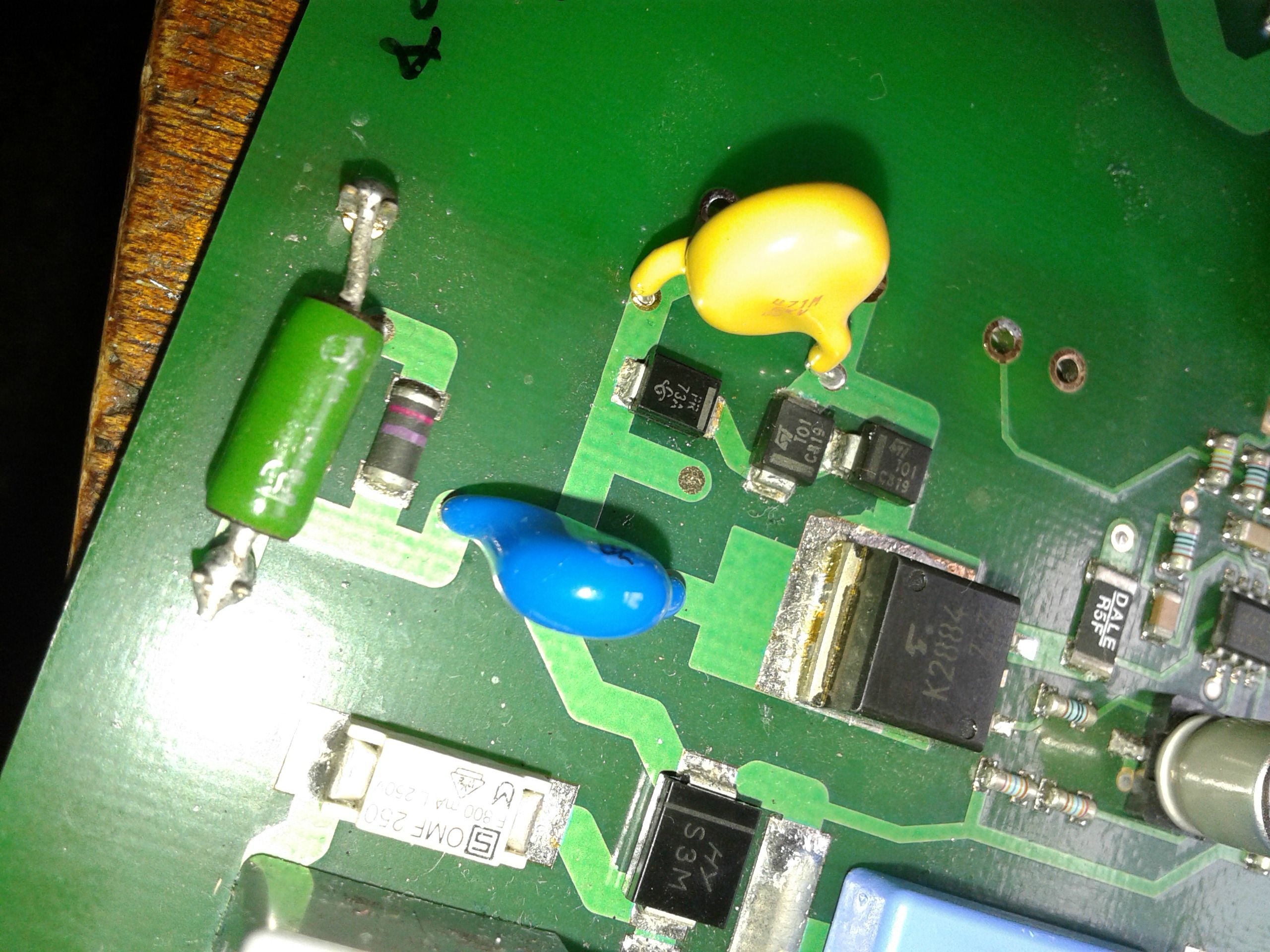

Hello everyone .
I am now trying to find a replacement for a diode that is shorted .
This diode is in parallel with a smps transformer main primary input.
I don't really know what type is it .
The psu input is from 80 V ac to 230 V ac.
Any ideas .
Here is a picture of the diode that i uploaded. ( the other hole is behind the yellow component)

So you removed the diode before determining it was shorted? In parallel to a transformer, it would appear shorted on the PCB.
Is your diode in the picture? I don't see it. A 73A diode would be much larger.

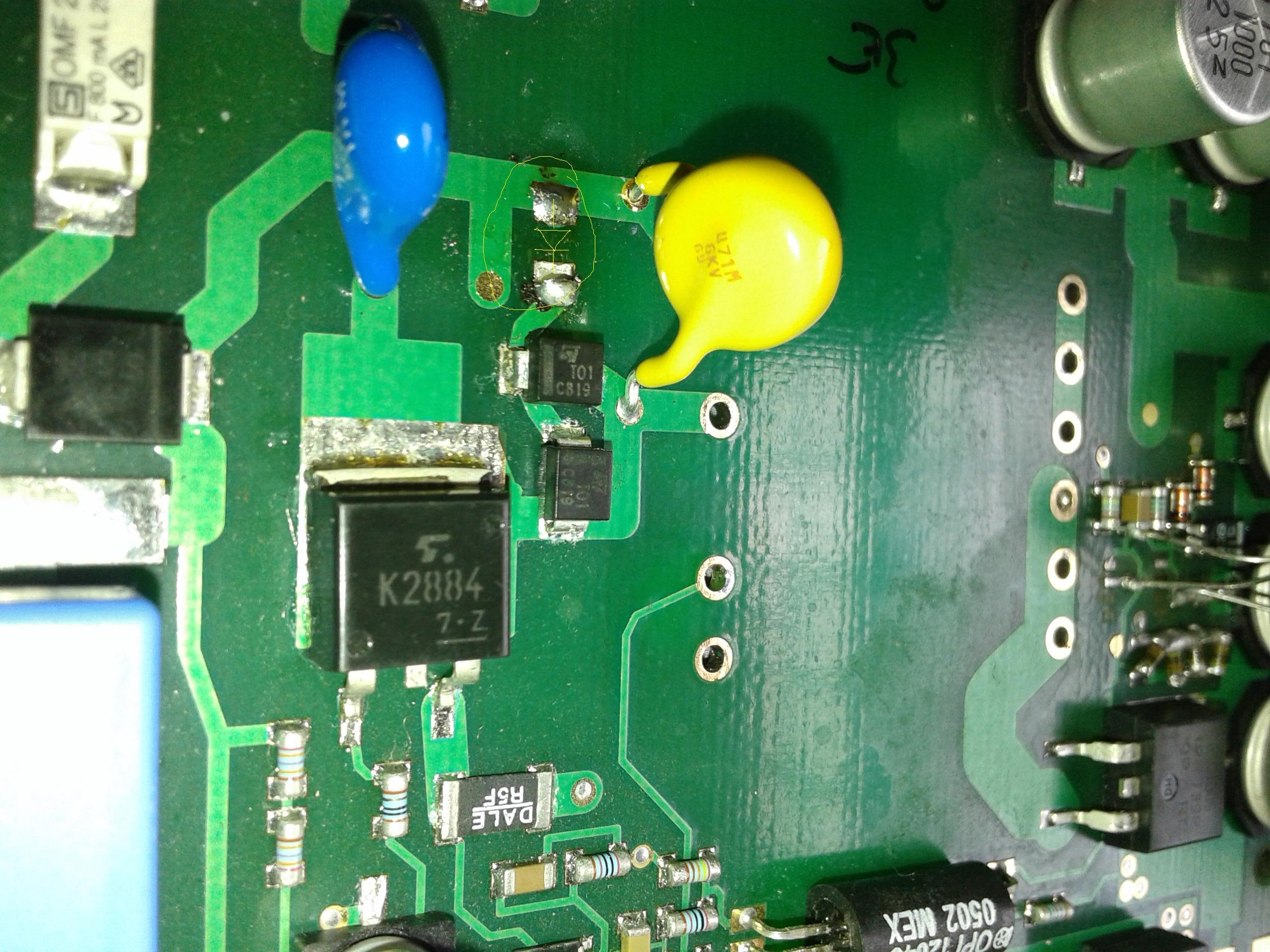

I of course removed it and it was shorted displaying 0.4 ohms both ways .
The diode is just near the yellow component , you can see the SMD solder pads.
Here is a picture of it befor removal :

The 2SK2884 is rated 800V, so the diode probably needs to be at least that, hard to judge the scale but I'd say at least 1A - maybe as much as 3A.
Pretty sure it'll be a fast-soft recovery type.

What interesting in this PSU , is that it doesn't have an oscillator apparently only a power factor corrector , and a tl431 at the output for charge monitoring i guess .
Could the power factor corrector be also doing the job of an oscillator ? the part is L6561D.

How do you know that it actually was a diode? Could be a transil for example.
Do you mean transient voltage suppressor ?
I searched for the logo name and it belongs to general semi , but still cannot find a datasheet for it.
Apparently you can also get resistors disguised with SMD semiconductor codes - but in one of the pictures, the part in question has a polarity bar on the case which seems unlikely. Also a resistor would be bigger than that in a snubber - and there are some the right size nearby.
