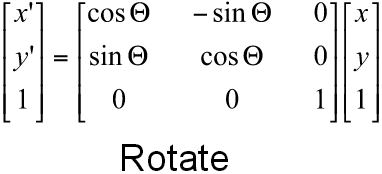

Expand the matrix multiplication and compare the results with what one would obtain doing it without matrix arithmetic.
MrChips
Joined Oct 2, 2009
34,909
Start with a smaller image to get an idea of how matrix rotation works.
Suppose you have a 16 x 16 image.
There are 256 pixels. Each pixel has a colour or density value.
Each pixel is given its ( x, y ) coordinates and its colour.
To describe the image in matrix form, we create a 2-d matrix, example m(16, 16) with a colour value at each element in the matrix.
Now we can multiply this matrix with a rotational matrix:

That is the matrix i use too but because for most computer 2d graphics we have, well, just two dimensions, that easily reduces to just a 2x2 matrix, and from there it's just two simple equations and that can be applied directly.
However, there is an interpolation stage that must come next in order to reduce pixelation because for unusual angles we never get result pixels falling on exact existing pixel locations.

for solving this cos value which processor will be used?
Hi,
You mean in a multi processor system perhaps?
In that case you would use ALL the available processors if it was a dedicated system, or just maybe 80 percent of the available processors if it still needed user input, but of course since processor count is an integer usually not too high you have to base it partly on the actual number, such as 2, 4, 6, 8, etc. With only two processors for example you only have the choice of 1 or 2, and if you use both it makes it harder on the user if there is one.
There are two approaches too depending on the kind of jobs to be done. The first is to assign as many processors to one image as possible, and then 'mend' the seams, the second is to assign one processor to each image when there are multiple images to be done when there ae usually more images than processors.
In any case though as mentioned previously, there needs to be a follow up pixel interpolation in order to create the illusion of a smooth, non pixeled surface where points can be placed anywhere in the 2d space rather than on just pixel point locations (in a 100x200 image here are only 20000 true pixel locations but an image rotation lands pixels in a continuous 2d field where we never get lucky enough to get them all at the original points except for 90 degree and integer multiples of 90 degree rotations). This is more commonly referred to as "anti aliasing".
