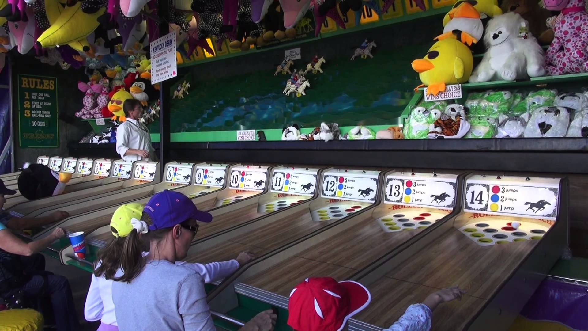

This will probably answer most questions. What I am trying to built is a carnival horse racing game such as this one:
Under the center line of each isle there are three switches one after the other inline with the ball's return path. If a ball drops in a red hole, the ball will trigger S1, S2 and S3 (output high for the longest duration). If it drops in a gray hole only S2 and S3 are triggered (output high for medium duration). Yellow only triggers S3 (output high for the shortest duration). This is why I am trying to disable all additional triggers after the first one.

At the moment, it is an old electromechanical system, very old and ingenious design that worth studying as a novelty item :p . It is beautiful (if you are a romantic), served its purpose for decades and now belongs in a museum as it consists of over 50 3P2T relays and timer relays. I am very confident servicing it, I've done it for years and I do understand it (electromechanical automations is my thing), but it is time to replace all of it now and I think it should become electronic given the chance of replacement.
one ball rolls down the 2 point track, followed by a 3 point ball
Good thinking, but that will never happen. In any case, the possible button scenarios are (exclusively in the order mentioned bellow):
1) No button pressed (the ball does not fall in a hole)
1) S1, S2, S3 (the ball goes in red, long run)
2) S2, S3 (the ball goes in gray, medium run)
3) S3 (the ball goes in yellow, short run)
But even a long run will run out before the ball returns to the player, is thrown again and goes back in a hole (this is taken care from the slope of the return path, underneath the isles. There is no way to hit any two buttons in less than 4 seconds and the long run should be no more than 3 seconds, otherwise the game ends too soon for good (or more likely lucky) players. So, no way to re-trigger while the timer is still running.
