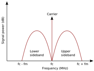

One thing to note is the low pass filter or some other thing is not doing a linear interpolation or some other function to pull out the original signal: the original signal is contained within the digital samples in it's total and complete form.
I saw a proof of this in a communication systems class where we typically worked in the frequency domain, but first a digression.
Consider an AM modulated signal. The "baseband" signal is bandwidth limited to fm, and is impressed on a carried of frequency fc. The resultant AM signal is a carrier frequency of fc with side bands from (fc - fw) to (fc + fw).
It looks like so:
And of course you AM modulate a signal by multiplying it with the carrier.
Now think of an analog to digital converter. First it must sample the analog, and one way to think of that is to imagine a special signal. The special signal will have frequency fs of the sampling rate, and a value of 1 for a very short (ideally zero) length of time. If you then multiply the "baseband" signal by this special signal you get the digital samples.
These *are* the digital samples, not the "numbers" counted in bits. That is the next step an important step too, but eventually they will be converted back to these samples.
But what are these samples like? First, there are two things to recognize about the special signal: One, it is periodic and two, it has a DC value. Periodic because it repeats exactly at the sampling rate. It has a DC value because the value of 1 has a DC (or constant) value
If it is periodic then it may be decomposed into a series of sinewaves at frequency fc, 2fc, 3fc, and so on. Each of these frequencies acts as the carrier signal for an AM signal, just as the above figure shows, if you allow for many many additional carrier waves. Actually the higher frequency components don't matter much, as I'll show.
Now take that DC value of the sampling rate and multiply the baseband by it and you get... the very same baseband signal differing only by amplitude.
That is why all you need to convert back is a low pass filter: the signal is already right there.
Here's another point: to keep that recovered baseband signal clean you want to keep the sample signal out of it. In other words (look back at the figure) you want to make sure that (fc - fm) > fm, or
fc > 2fm
If that looks to you just like the Nyquist sampling frequency then well, now you know why.
You're welcome. :)

Nor does it need to know. The original signal is already contained in the digitatized samples. All that needs be done is to filter out the high frequency artifacts of the sampling process.
It is probably impossible to visualize that in the time domain, but dirt simple in the frequency domain.
I need to add a figure to show that in my previous long post.
