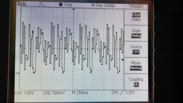

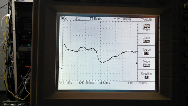

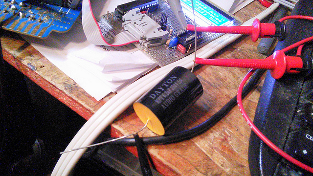

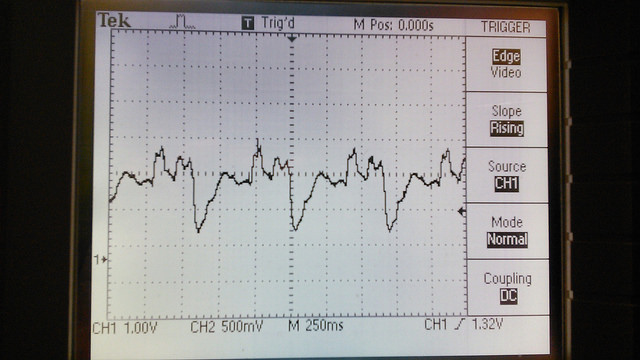

Raw 'DAC' output from a PIC18F25K22 5-bit output from the rand PRNG to repeat the 'random' signal pattern.
Fancy low pass filter (6.2uf to ground from the DAC voltage reference output impedance) directly on the PIC output pin.
Results: Almost looks like a 'real' audio signal.
