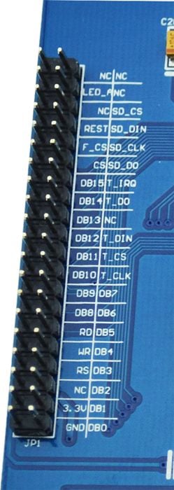

yes but these are not on TFT interface, looks like some of data pins D0 to D15 are used for serial communication alternatively, i uploaded image for pin reference

THE_RB
Joined Feb 11, 2008
5,438
No, they are the SPI pins for the SD card which is also on the PCB.
And the pins marked T_xx are SPI for the touchpanel controller.
The display pins are on the left side, REST, CS, RD, WR, RS etc.
It's a standard China ebay TFT pinout and there are plenty of wiring diagrams and code examples to google.

there is also SPI interface for SD Card and Touch Panel, SD_CLK ... are pins for SD Card, T_CLK pins are Touch Panel interface. While reading different datasheets i understand some of data pins (D0 to D15) act as SPI interface in serial mode.

Ah, that explains SD in front.
