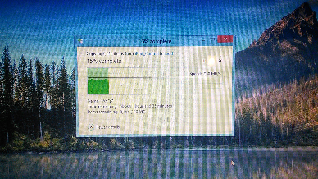

Even if the program can "optimize" TCP throughput, one bottleneck in the chain will slow overall speed to that.
Example: Running a backup of the cars IPOD 160 to the file server via the USB Apple connector on a laptop with a 1G connection. The network speed is not the limiting factor.

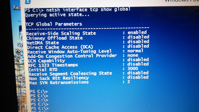

Well...you could play with the TCP receive window size but newer windows is supposed to auto adjust.
Don't need an optimizer for that...

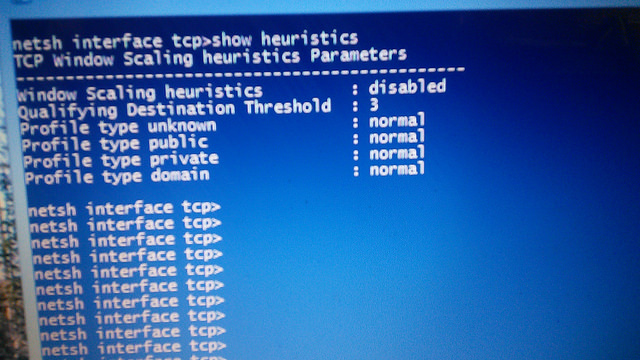

The heuristics is set to 'normal' for local Home/Work networks in WIN8. For Public networks it might be "restricted" and cause slowing on fast networks but that's easily fixed with the right netsh commands.
I have it set to auto adjust in all modes on my laptop.
