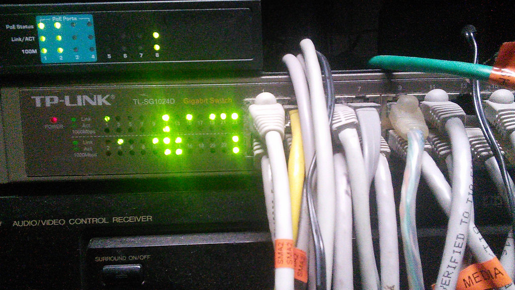

Only to show that I still use the file system for cases where video streaming is important. (8 cameras with 3MP ipcams on the home system)
