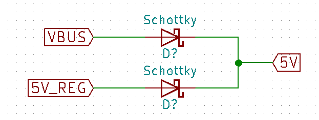

Then the solution is simple. Use one 1N5817 diode and one 1N4001 diode.
The source connected to the 1N5817 diode will take have first priority in delivering the power.
