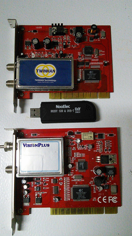

DVB(S orT) is a common method used to transmit satellite (or over the the air in the EU) information. I have a pile of old PCI boards that I once used but they have been replaced by USB dongles like the one in the middle for RF from 0.5mHz to 1Ghz with a external frequency converter front-end or satcom.

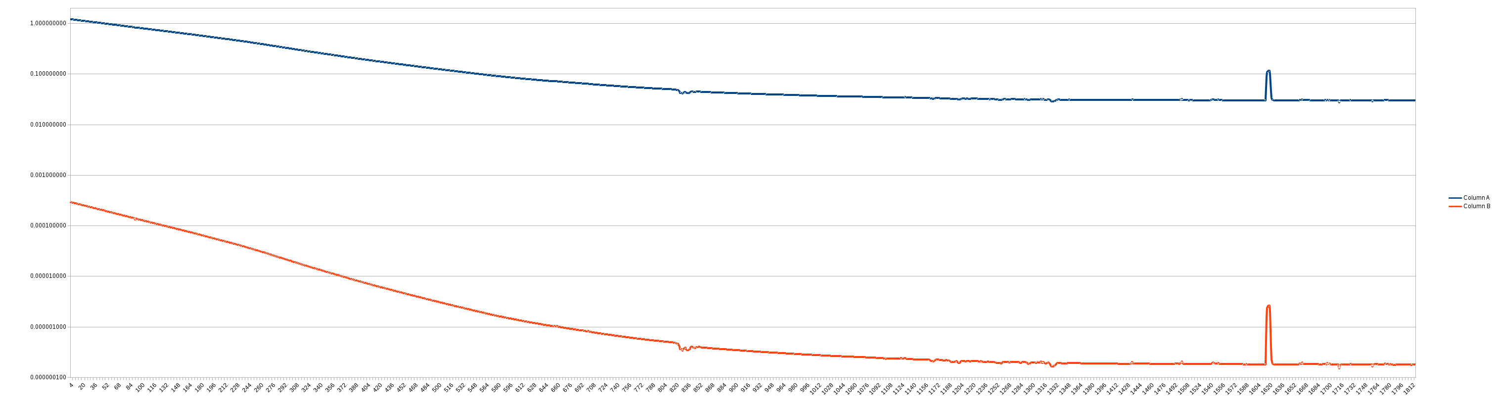

Running some baseline charts with the Raspberry Pi DAQ system. This is a sunset to night sky (with some cloud cover) with about a 20% moon in the sky. The first little glitch is me moving the panels (3 80W panels isolated from the rest of the panels) to line up with the moons position in the sky, the second large spike is from a cars headlights driving out of the cul-de-sac I live in.
Y Log scale for Volts in BLUE and Watts in RED, X sample number.

Is that a little over a volt, I see?

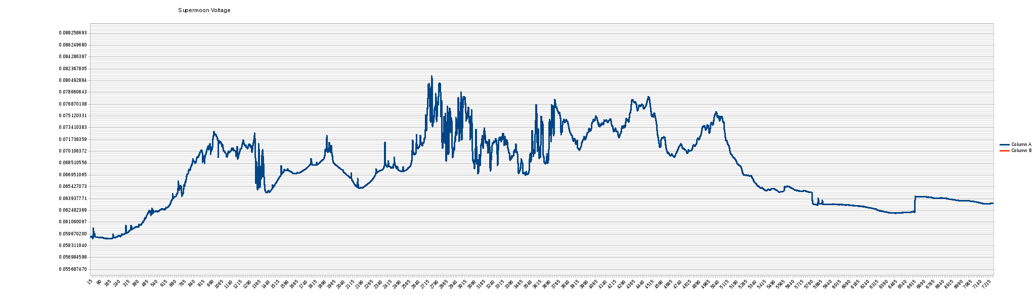

Here is the chart from most of last night as the moon moves into range and sets. It's starting to look like the weather might not be good on the Blood-moon night near Portland as the chart shows the light variations from cloud cover and ice crystals high in the sky.
My pictures of it are poor but this one from the net is close to what was happening.
Those sharp isolated spikes in the first part of the chart were driving me crazy as I thought there was a defect somewhere causing them but I matched the times to airplanes flying near the house (I'm in the glide-path for PDX) after seeing the spikes stopped after about midnight.

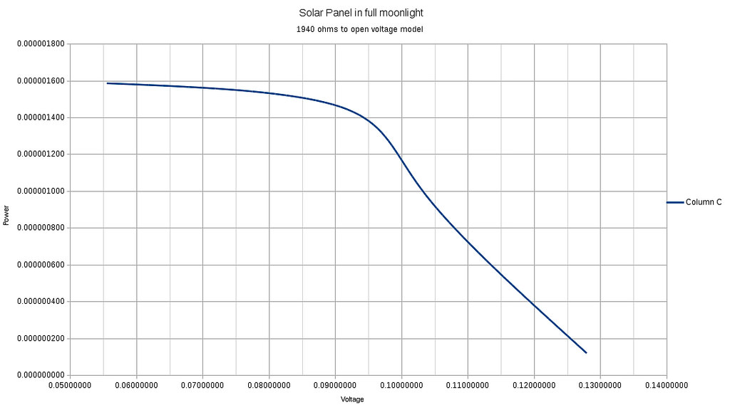

Finally had some time to start working the numbers from the data.
It's hard to find information about PV panels at other than standard operation conditions but there are a few papers about low light operation that I used to model the data for some future use.
The first step is to look at Voc vs changing load resistance vs power with a panel internal shunt resistance of about 100,000 ohms in the model.
Samples are every three seconds from the start of the logging program. (some of the data log for the resistor tests)

Measured voltage under full moon light with open circuit, 4.7k, 1.0k and 10.0k resistors vs voltage.
The Power/Voltage model graph. (that includes resistance in the panel to ADC protection circuit)
You can see a somewhat typical Solar PN curve even at low-light levels.

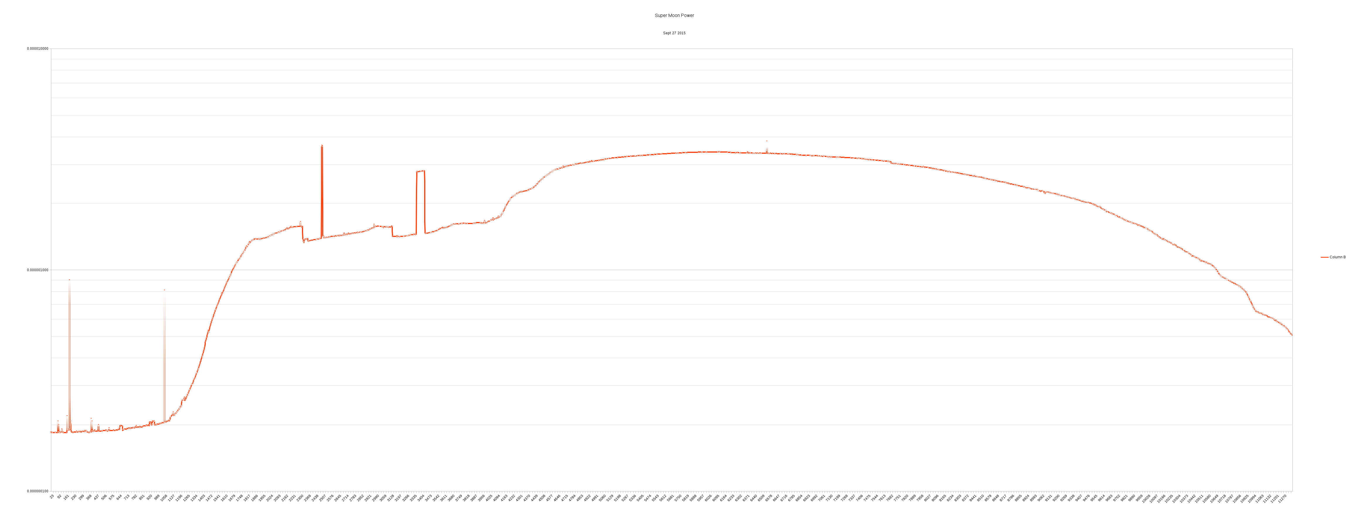

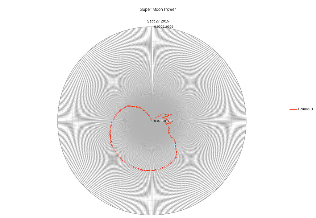

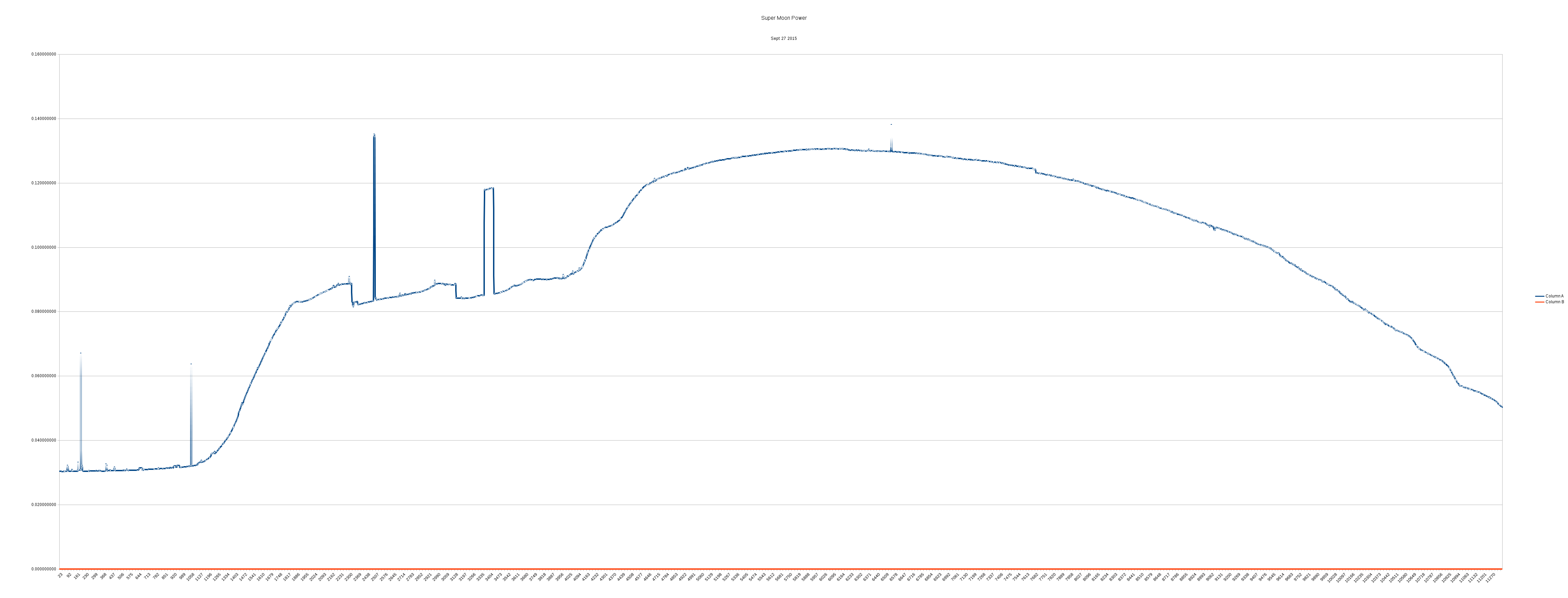

All eclipse voltage, power, current data and graphs are with the 4.7K load resistor.
It starts at almost full 'Blood' stage (the tall sharp spikes are car lights) and moves to left -> right to full moonlight.
The first ramp is the main panel array in moonlight (the small ramps are me moving the array to center sky and the longer spike is an open circuit voltage reading taken by removing the 4.7K load for a while for model data)
The second ramp is when the other panel array starts getting full moonlight and both arrays are in view of the full moon until early morning when the program is stopped before dawn.
Really large images.
Power:
Voltage:
Time is clockwise on this Power graph (spikes removed):
