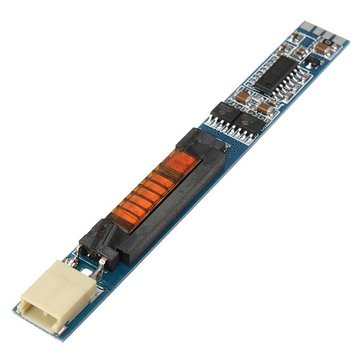

Yes. Inclination sensor. I found a gyroscope for Arduino
- Li Polymer Battery
- 4x inverter fluorescent lamp for monitor. Is enough the voltage it offers?
To say the weight of the battery is related to its capacity.
But the capacity of the battery is not directly dependent on the lifting force.
Force and energy are different,
A small capacity battery can hold it up for a very short time.
The problem is if it can pick up those voltage inverters. And I think he can!
It was just an example. I can buy different models.I prefer to be with TL494 to control them fast.)
