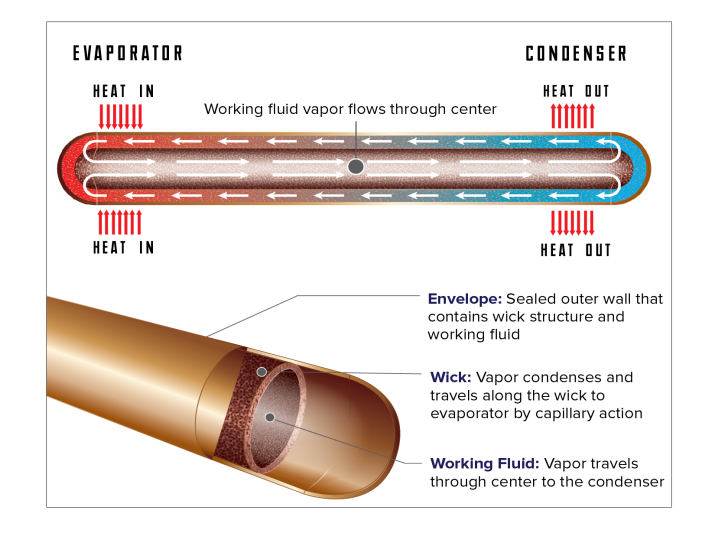

But something told me your figure for the heat was a bit low ... A search shows the best leds are only 25% efficient .. so a 200W led needs to dissipate 150W in heat!!
A candle is listed as 0.04% efficient ...florescent /halied around 12% ...incandescent 1.5%
Yes the very best heat sink is essential otherwise it would blow very quick ..
Those are copper tubes ... evacuated with a fluid inside , often water , and a wick ...Heat pipes ....
