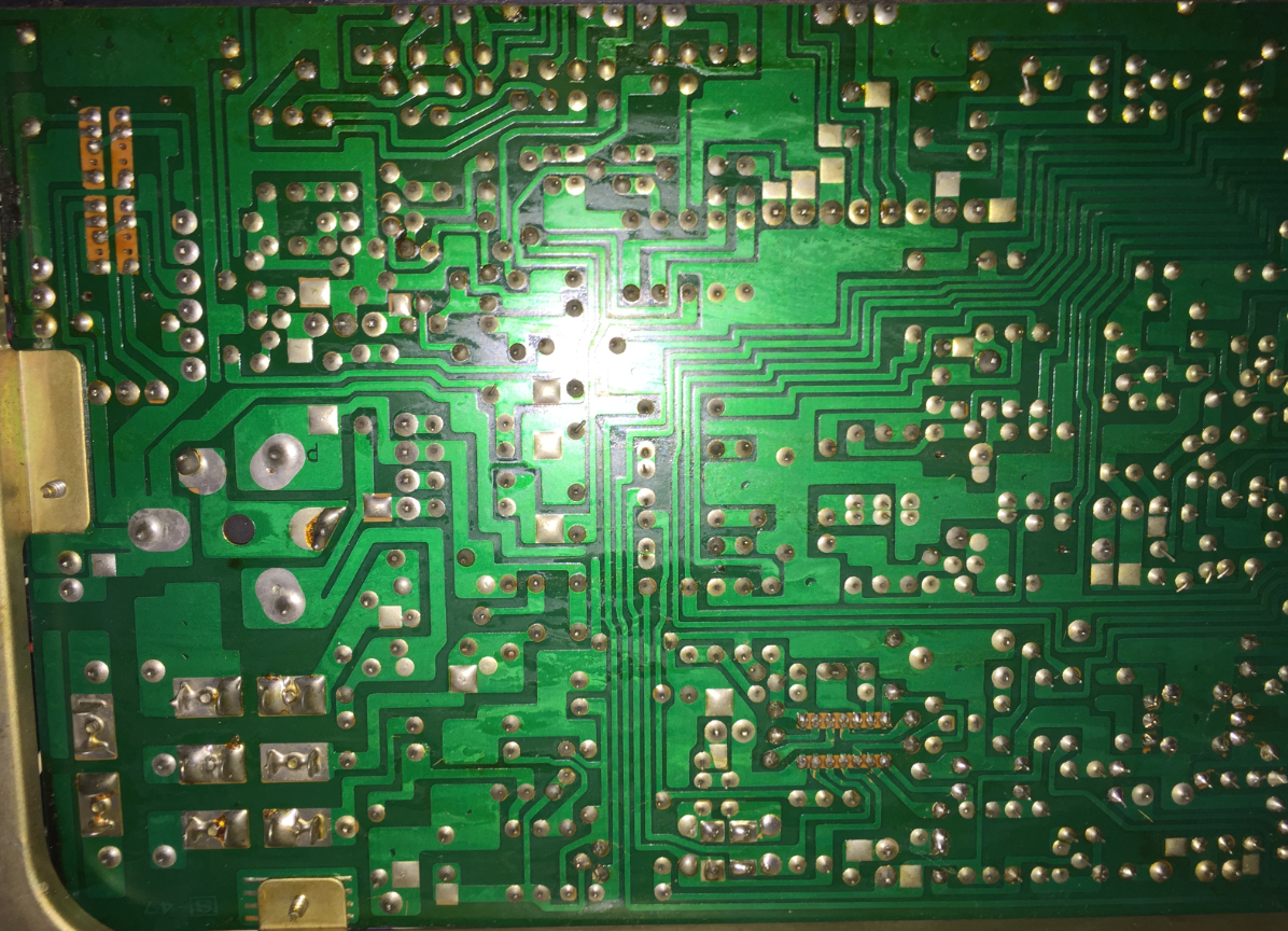

I'm a really big noob, so I've tried Googling some things. Some posts suggested checking the transistors, so I did. The NPN once read around 0.53V B-C, B-E and the PNP's read around 0.6V too. The resistance for all transistors from E-C was okay, well at least it gave a large resistance and not something that is striving for a zero value. I've tried checking the speakers connections, and I've found out that the black connection, the minus one, at the B speakers isn't connected together. Maybe it's just an old wire, but what it's really that, how do I diagnose the problems?
Therse a dual C filter cap, that means it's a cap based on two capacitors that have the same minus lead (Parallel?). Do I need to change that big cap? and can I change it with two of the same value capacitor? I've tried searching for the dual c cap, but no luck...

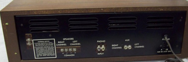

I've included a photo of a random old amp from Google images, hope that I can explain it well.

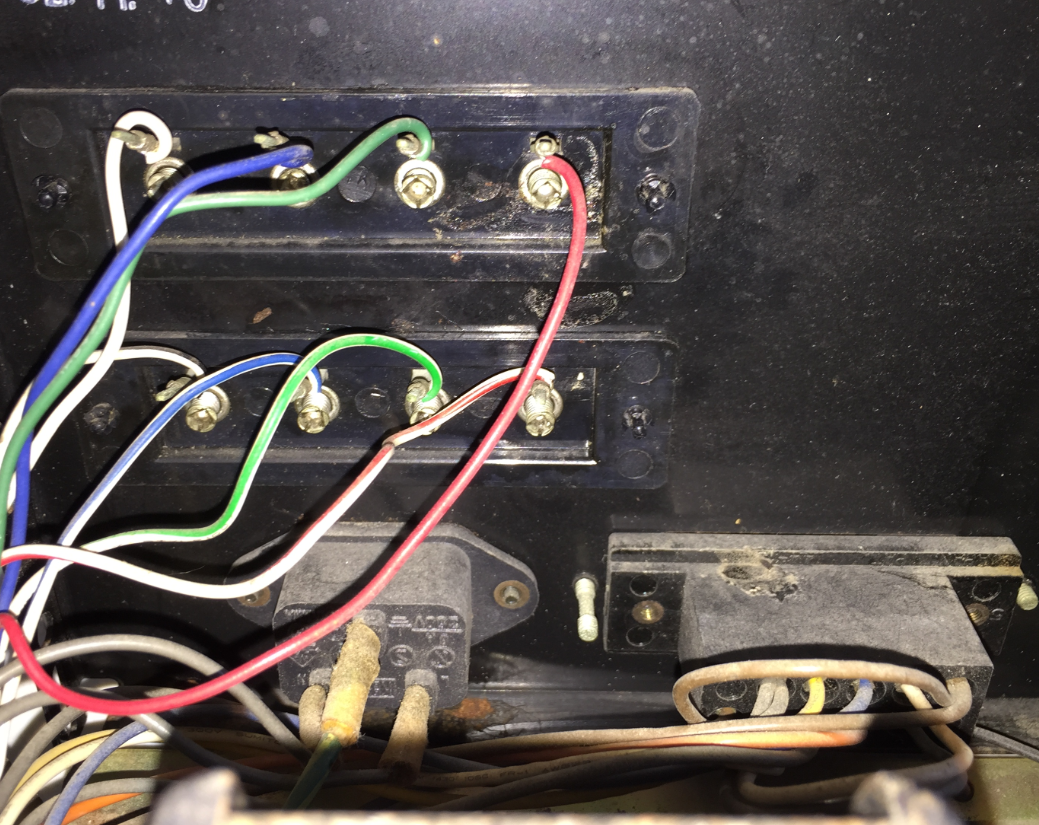

Look at the speaker connctions, you have left and right, and in between you have two common minus leads. I have two configs, one for a set of two speakers called A and another one called B, so that I can choose witch speakers I would like to hear my music from. When I try the continuity test on the two speaker connections in the speaker set A, I get a buzzing sound when putting the two leads in each one of the common minus connections (One for right and one for left), hence every thing is good. Now, in most amp you have two speakers set, like i've explained earlier - set A and set B - but when I do that same test, the common minus connections in speaker B down't have a connection, witch should be alarming, or i'm just a really derpy noob.

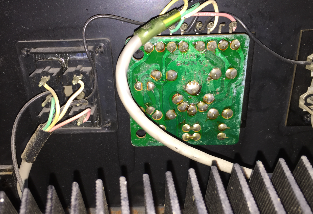

Oh, I'll def try it. Too bad Amazon doesn't ship to Israel... Do you think it's a good Idea to go on and clean the solder joints in the phono/tape connections with isopropyl alcohol? As you can see, the 2nd photo features the PCB for the tape connections and it has some white crap on it. Hope to hear from you soon!
