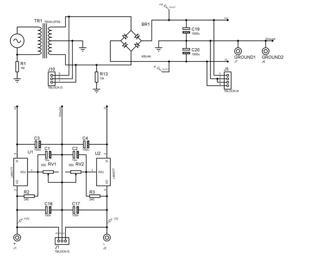

Hi, I ask for a possible improvement for this circuit. In particular (but not only) if it is necessary to add or remove something to improve the noise. Even though it should be pretty quiet already. It should / can be used to power low noise devices (eg opamp or jfet).
Thank you!

What voltages on the outputs do you require?
If they are fixed, I would use fixed voltage regulators.
What is the max current output required?
Remove R1 and R13.

Why did you draw the regulator circuitry sideways? It's normally drawn with the input on the left and the output on the right.
You're using linear regulators. Where do you think noise would come from?

Do you need both positive and negative voltage output?
Are the two voltages the same amplitude or are they independently adjusted?

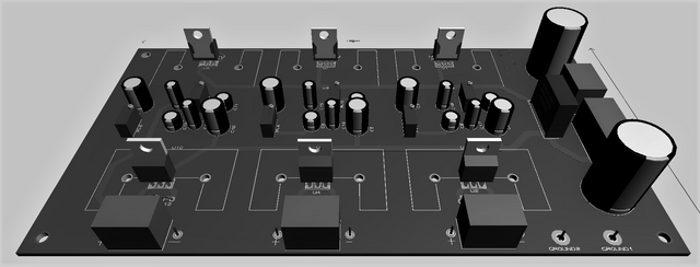

Ok for R1 and R13. According to the regulators I believe the maximum current is 1.5A with a good heatsink. In the first possible intended use I will use a stage at + -5Volt max 100mA and a second stage at + -12Volt always 500mA. The transformer comes out with 18 0 18. Also for this reason I have also prepared large heatsinks on the 5V.
The heatsink fingerprint is suitable for models ranging from 3 to 4.8C / W i.e. these .
The original design includes multiple adjustable output stages but I have only brought back one. What I want to have is the ability to have a power stage with multiple simultaneous outputs if needed. I would have liked to have used more current regulators like an LM1084 but there doesn't seem to be the negative counterpart. Unless 1084 is both positive and negative.
As for the noise of linear regulators, it is true that they are normally silent but I have seen linear stages that had inductors on the output. From here I thought they were needed for the noise.
Lastly, I also ask for an estimate of the width of the regulator input and output tracks. Currently they are set 0.1in. making them wider makes little sense given the width of the pads. I err?
Thank you.

Yes, I could use a transistor like a 3055 but I am trying to contain the PCB size which is already big enough.
You could use a power transistor in a TO-220 package. Stand it up near the edge of the board so the heatsink can hang over the side. Doing that would likely make it difficult to have the regulators protect the pass transistors.

Regarding improvements. Those regulators aren't guaranteed to regulate with less than a 10mA load current. The current set resistor value you chose won't do that, so the regulators might not work until you increase the load current to at least 10mA. I once had an LM317 (from STM) that needed more than 10mA before it would work.

Texas instruments make some very low noise regulators for both positive and negative voltages.
https://www.ti.com/power-management/linear-regulators-ldo/products.html#p238max=7.01;30
But they can't manage anywhere near 1.5A.
But if you have some very low-noise circuitry, I can't imagine it needing anywhere near 1.5A.
Perhaps your low-noise circuitry should have its own regulator, so that other circuitry connected to the same regulator can't introduce noise. In that case you won't need 1.5A.
