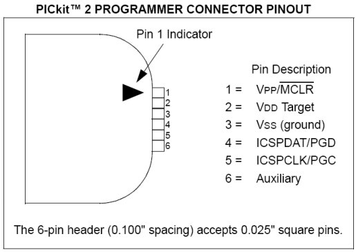

This is the circuit you need to use. Please check that you have the pins connected correctly:
You may leave out the LED and 300 ohm resistor if desired, they are not required.
Here is the pinout of the PICkit:
It appears that the PICkit is not seeing your PIC:
Target Device ID(Ox0) does not match expected Device ID Ox1240
Reading 0x0 suggests that PGC or PGD are connected incorrectly. Make sure they are connected properly (not swapped) and ensure they are not loose.
Are you using a breadboard? Are you powering externally during programming, or are you allowing the PICkit to supply power?

"Target Device ID(Ox0) does not match expected Device ID Ox1240"
Note the return value: all zeros. You get the same data when reading registers. Check your connections to the PICkit carefully. Something is amiss.
The PICkit can power the device during programming, and for lightly loaded projects as well. I would leave the batttery off during programming as I would worry that the excessively large voltage could damage the PICkit. Do note that while the absolute max for the PIC is 7.5V the opperating voltage only goes to 5.5V.
I have never connected pin 6 of any PICkit to anything. It is only used for Low-Voltage ICSP Programming.
