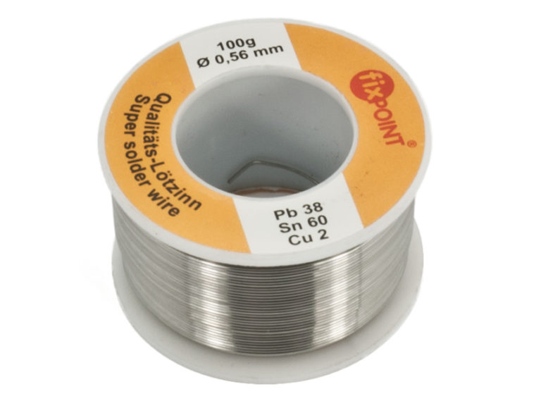

Also if that is a picture of the solder your using to solder batteries, that is part of the problem, it's lead free solder. It takes way more heat than regular lead solder. And no lead solder is not harmful to you as long as your not eating it.

Really?
A few years ago, after some research I thought I had bought the "perfect" soldering wire with those percentages (38% Pb, 60% Sn, 2% Cu)...
Lead free you say?
There a big clear 38% Pb on the specs. Why did you say lead free?

Lead free you say?
My bad, miss read the PB.
