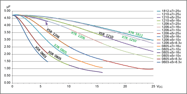

Its peculiar to Ceramics, so film, mylar, teflon, maybe better
choice. T dependence in datasheets a must read.
Or now many processors with onboard osc "trimmed" at production
test a much better timing element. In the couple of % range.
