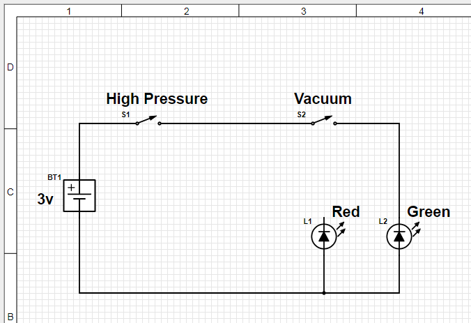

I am making vacuum lifts, and I want to put a little safety light on them.
My question is how to do it best to work off battery power (3vdc). Both switches you see are mechanically activated contacts.
What I want-
Initial state shall have no switch activated, and have no parasitic draw (for battery life when not in use). No lights shall be on.
When both the High Pressure switch and the Vacuum switch are triggered, the green light shall be ON. This means it is OK to lift.
When either the High Pressure switch, or the Vacuum switch is cut off, the green light should go OFF, and the red light should come ON. This means the lift lost source pressure, but is still holding vacuum by the reserve tank.
When both switches are cut off, the circuit returns to initial state. (both lights off).
Is this feasible with basic components? I have been racking my brain on this, and not sure if I am over thinking it.

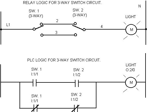

You could do this if the switches had additional contacts. You would use three-way switches.
Since it is unlikely that you have additional contacts the only other solution is to use additional logic, relays, or PLC.

I forgot to mention the reason I was having problems was because I don't have NC contacts. NO only.
And I have looked for other vacuum switches, they just don't make very many kinds.
Yes, if I had NC contacts on the switches, it would be easy.

This part doesn't make any sense:
First, this includes the case in which BOTH switches are cut off. Do you mean "When one switch is off but the other is on"?
If so, then does the high pressure switch being on while the vacuum switch is off also mean that the "lift lost source pressure, but is still holding vacuum by the reserve tank."?
I think you need to spend a moment making sure that your needs are very clearly thought out and expressed.
You have four states. What do you want the lights to do for each of the four?
pressure=OPEN; vacuum = OPEN=> red = OFF; green = OFF
pressure=CLOSED; vacuum = CLOSED => red = ?; green = ?
pressure=OPEN; vacuum = CLOSED => red = ON; green = OFF
pressure=CLOSED; vacuum = CLOSED => red = OFF; green = ON

WBahn, sorry, I wrote that wrong. I was initially going to make a "dont care" circuit (just lights on a switch), but it's a lot better for the user of the lift to have the lights work logically. If both lights were on all the time, and only went out when their corresponding pressure was lost, the user probably wouldn't notice the change right away- and seconds will matter in this case.
The lift uses a venturi to create a vacuum from a high pressure, high cfm source. For reference, this is approx 100psi around 8cfm to create -15hg of vacuum on a suction pad. There is a small (a few cubic inches) reserve tank that is on the vacuum line to hold a reserve suction, and is isolated by a check valve from the source. This allows the lift to hold vacuum for a few seconds even if the source pressure is lost. Problem is, if the user doesn't realize the source pressure has dropped to a dangerous level, the vacuum could let go and the lift would drop the load. These loads are 500lb+ stones, and could ruin someones life if they fell on them.
That is why I want logic between the green and red states. I want it to be very clear to the user that a dangerous situation is occurring, so they can get out of the way immediately.
It should state as follows-
pressure=OPEN; vacuum = OPEN=> red = OFF; green = OFF (no parasitic drain in this mode)
pressure=CLOSED; vacuum = OPEN => red = OFF; green = OFF
If I make the CMOS circuit, as MrChips suggests, to do this, I believe I would have to have a time-out feature to cut off the parasitic drain of the circuit. I could do this with a vibration switch on a 555 timer (or just buy a module off ebay that does this).

But you could try something like this..
The added diode above the red will make the on volts too high for the red led to light when the green led is on.
When the switches are open. the red led will light, and when they are both closed, the green led will light.
You will probably have to test leds to get the correct ones as the forward voltages vary quite a bit.
Use high intensity leds if you can.
Limiting it to 3V can make it a bit harder, but have a go.

This was my very first thought when I decided I needed these lights. It's crude, but for such a simple project it might be best. I might try this. The only issue is when the lift is not being used, both lights need to be off... and I dont want them to use a switch to turn the circuit on because they won't do it. It would need to be tied to a vibration switch that latches the circuit on for a set period (say a few minutes).

Your simplest solution is to connect each switch to individual LEDs through a series resistor.
Both LEDs must be ON for normal safe operating mode.

How about, in addition to two RED LEDs, one on each switch, a single GREEN LED when both RED LEDs are ON.
This can be implemented with one transistor.
