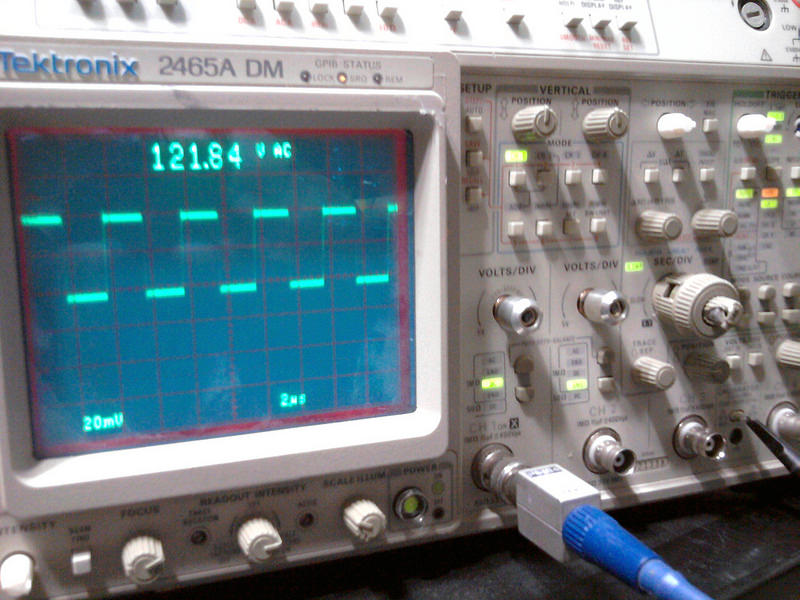

Hi all,
I am a former lurker who just acquired my first oscilloscope. I've done a fair bit of reading and video tutorial watching, and I'm beginning to get comfortable with the scope, but I'm seeing something on mine that I haven't noticed in any videos I've watched, and I just wanted to ask about it. I hope this is not a ridiculous question to ask. I've done a lot of googling and been unable to find much relevant info, but maybe I just don't know the right term to search for.
Short version: On a lot of the square waves I look at, the edges (except the one I'm triggering on) flicker and jump left and right between two different positions.
So, I'm wondering if it's one or more of the below:
A) There is something don't understand about how to set up the trigger or other scope parameters to stabilize the waveform
B) The signals I'm probing just have some variance and the scope is accurately representing it, and I shouldn't sweat it
C) It's caused by some kind of external interference
D) There is a problem with my scope or probes
E) It's totally normal and I shouldn't worry about it
Here are some screenshots that show what I am talking about:

Only a guess, but I would think the scope is showing a variation in the duty cycle of the square wave. Looking at the center picture, I see both rising edges of the first two cycles to be nice and straight, but the fall time of both show variation. The third cycle shows variation of both rise and fall being shaky. Do you have any ripple on the power supply to the signal generator you built? It may not take a lot to have an effect on the output.

Definitely jitter on the incoming waveform. Looks like it is a software generated square wave, where the jitter is caused by an instruction cycle or so worth of uncertainty.

Just noticed something else.... Set your signal generator to 20 or 40 Khz. 35Khz is not an even division from the 20Mhz clock in your signal gen.

I just did an experiment.. I have a function gen similar to but not exactly like yours. Although not as pronounced as what you are seeing, I see something very similar on my Techtronix scope. Just changing the output frequency by a few hundred cycles cause the problem to be greater or lesser. I think all posters have come to an agreement that it is the output of your signal generator and not your scope that is cause and probably a result of the countdown process from the 20 Mhz.

When I went to check for ripple, I set it to AC coupling and then just sort of fiddled around, zooming in and out on both axes. Here's what I saw:
I figured it was alright, no? I see no resemblance:
I also probed the test points on the board in the FG. I found the output signal at a couple of spots. One was near the output BNC plug, and another was near an Atmel chip closer to the middle of the board. But in both cases, it still looked the same with the "wiggle."
I set it to 20 KHz and 40 and also just scanned up and down a bit, checking in 500Hz increments. Like you, I saw that the effect is worse at some frequencies than others.
I was thinking, if this case of the twitching edge is just the source, what about the other signals where I saw it on edges in a signal from my Arduino? So, I found the signal in question again, and it was still doing something similar, but this time, having done a lot of fiddling with the trigger settings while troubleshooting the FG, I was able to mess around and get it to lock in nice and solid. So, seems like case closed!
