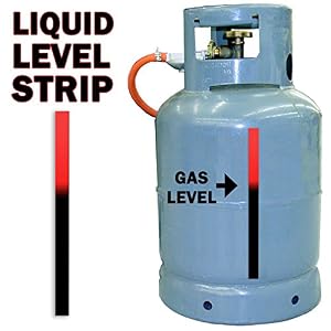

Luckily the nitrogen supplier went to a new gauge on the tanks that actually work reliably this time..
We had these little like float level indicators on the large Liquid LN tanks which worked pretty well and yeah, those things are heavy! I liked that the large ones had wheels. :)
