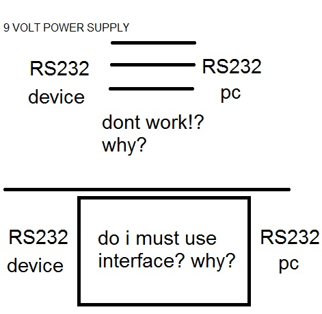

hi
i have a device with RS232 communication port ,power supply is 9 volt in this device , but As you know Valid signals are either in the range of +3 to +15 volts or the range −3 to −15 volts with respect to the ground/common pin in RS232. do this power supply will not create any problem ?
when connect directly device to pc RS232 , Do not communicate with each other ! And sometimes drop power supply!
Do I must use the interface circuit ؟

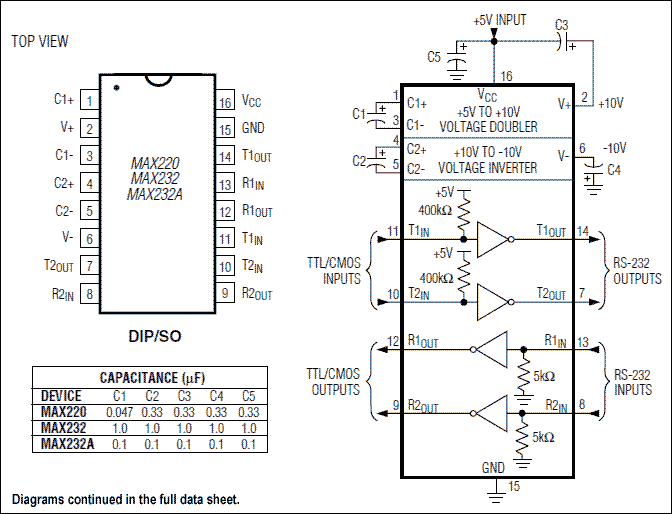

If you use a MAX232 it has internal charge pump for the ±v .
Alternatively there are dedicated RS232 drivers & recievers that also require a separate ±v charge pump supply.
Max.

thanks MAX, in your opinion , i must use two MAX232?! (RS232 to ttl and ttl to RS232)
what is your order of internal charged pump in max232 ?
You would use one on the RX end and one on the TX end, what is meant by your order?
I have used them for some years now with excellent results.

I mean, why should I use MAX232? Why can not directly connect them to each other?(Both is RS232)
what is internal charged pump in max232 ? why must use separate ±v charge pump supply(Except max232)?

They can both be connected together TTL - RS232 then back RS232 - TTL on each end.
The older technology IC used a few decades ago required the separate charge pump.
Or do you mean keep at the TTL level?

I do not understand that why direct connection do not work!
why must first convert RS232 to ttl level and then ttl to RS232 level? why directly dont work?

my device is ABB aquamaster . Does not matter device name Because RS232 IS RS232 :)
and I've done all the settings correct!

i use hiper terminal with flow control set on NONE,
device side is 3 wire
This is 1-4-6 & 7-8 on a 5 pin D.
Max.
I did not test this.
I test a RS232 Isolator(Buy this) But It does not work !
