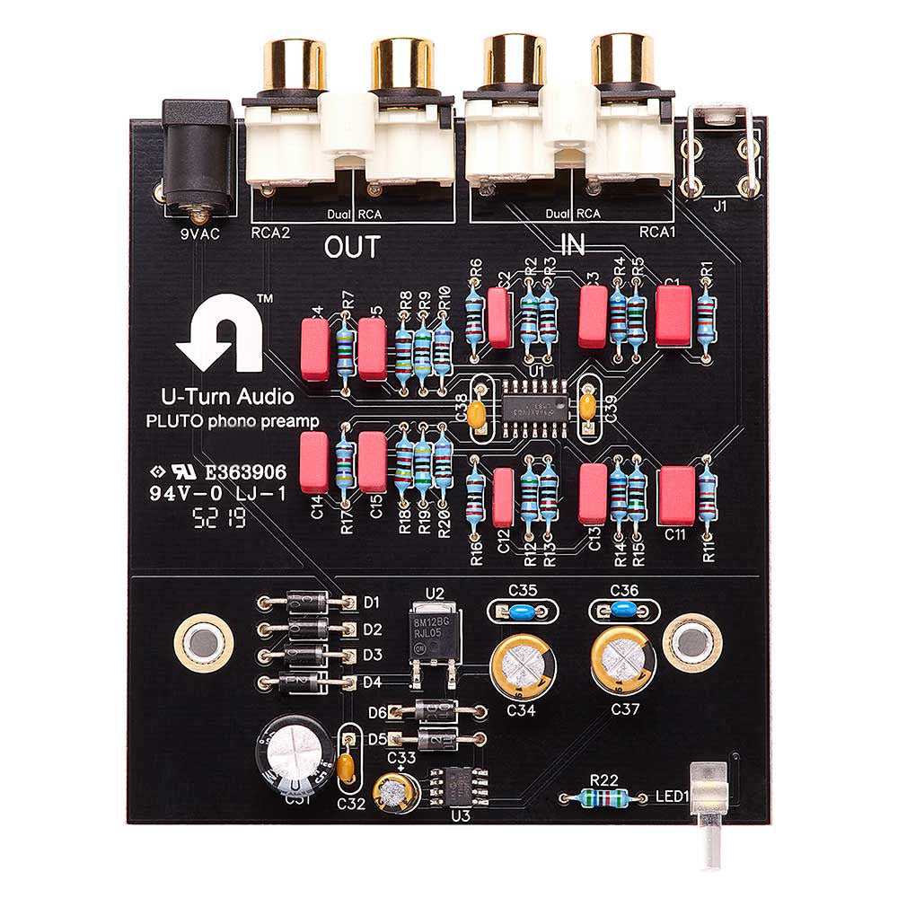

This is not my device, just a picture I could find. I see a few electrolytic caps on the power supply but none on the signal side.
A circuit won't work without power supply filtering, decoupling capacitors. It appears C38-39 are ceramic/tantalum
capacitors to prevent RF oscillations.
They simply placed the decoupling caps away from the signal path. If I remember correctly, the hum/noise is only
-70db down, which is not good.
cheers
pos

This is sad. Do you realize the harm you are creating to the community by hyping your
knowledge through exaggeration and deception; when you understand virtually no
electronic/electrical engineering, even the very basics?
I am a degreed electrical engineer with 40 plus years of professional analog design in military and space electronics, so don't insult me my telling me I don't know the basics.
What circuit design work have you done?
What's really sad is, you are the one spouting BS about audio circuits with your pseudo-scientific ramblings that the "golden ear" audiophiles often use, and insisting it is factual information.
The decoupling capacitors in your posted circuit have no effect on the audio, if they are properly sized, even if the caps are less than ideal.
If you did some calculations for an actual circuit, you would see that instead of using generalities that mean little.
