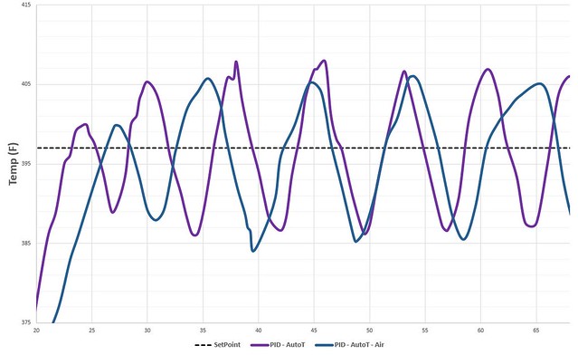

So I just had a thought... and want yall's opinion on this. I just re-ran the Auto tune on the controller. It's plotted as the PURPLE line below.
Musing the thought that just popped in my head:

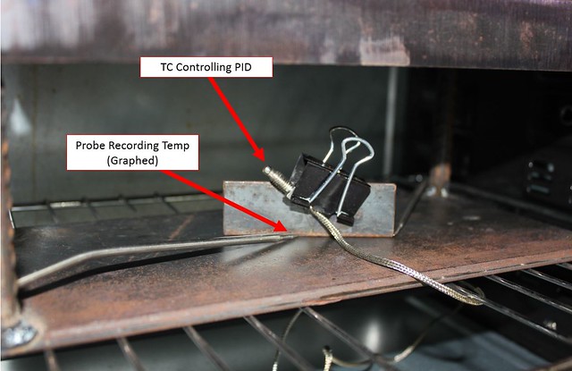

This whole time I've been reading the temperature off the probes I have sitting in the rack resting on the plate (As seen in the picture below). Do yall think that since these probes are "open air" they're showing a larger swing then what the PID's thermocouple screwed into the plate is actually reading? Maybe the plate is actually being held at the 397 F set-point and this Chinese controller isn't trash after all!?! :eek:

*Testing Set-up
Any thoughts appreciated!

Here are my thoughts.
I believe you are correct. If your data recorder temperature sensor is different from the PID controller's temperature sensor then you can expect some discrepancies.
With that new knowledge, the graphs in post #18 look good.
The steady-state error could simply be a result of off-calibration and I would not be too concerned about that.

Thanks for the feedback. It seems like it would be adventitious to have the TC in open air... maybe have the tip protrude up thought the plate by 1/16th. Wouldn't you want the TC to be the most sensitive thing in the oven?

So I had some time to get an initial test run.
This is the setup:
And these are the results of the first auto tuning cycle run by the controller with the TC in the air.

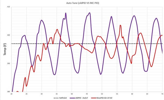

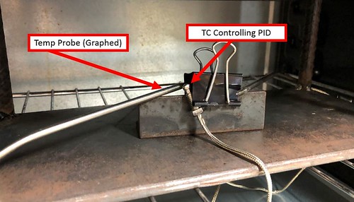

Ok... I think we're getting somewhere here. Got the new Rex-C100 RKC made in Japan PID controller wired up. And I swapped out the TC since my new controller came with a new TC and I trust it better than the one that came with the Chinese knockoff.
Testing Setup:
Head to Head Auto Tune performance (Knockoff Chinese version in PURPLE and New RKC PID in RED):
Notes / Vague Questions:
  • The AutoTune on the new controller yielded a P of 13 and I of 198 and a D of 49.
    • This may be a good starting place to tweak via manual tuning, I think.
  • Once the new RKC PID got up to the SV (setpoint) of 203C, the PV (measured via TC) never faltered from 203C. o_O
    • So... Maybe the cooking probe I'm using to record temp is slightly more sensitive than the TC? Or would that make the TC more sensitive than the TC... ?
    • Maybe the slight distance between the probe and the TC is what's causing the oscillation in the data (Red line on the graph)...?
      • They ended up being about 0.75'' apart in the test rig.
  • After getting up to temp, the total variance from the set-point of 397.4F was +6.1F above the set-point and -8.4F below the set-point (403.3F and 389F respectively).
    • According to the cooking probe
What do you guys think? :cool:

So I set the r value to 5 seconds and the df to 0000. Then re-auto-tuned the system.
Pretty much got the same results. It changed the P to 17, the I to 227 and the D to 56. The temp wings are the same as the red line above though. They mirror each other right on.

I left the df at 000 and the r @ 5
Then increased the "i" value to 450 (P17 and D 56).
That change brought the operating range to 400-392 with a setpoint of 397.
That's a total oscillation range of 8 degrees. It was oscillating with a range of 14.3 before increasing the "i" component. I think I may bring the "i" up a little more and see what happens.

Another thought... should I be trusting the cooking temp probes at all? Should the RED PV that reads out "current TC temp" be more accurate?
When auto-tuned that red PV stays flat at the set point.
It almost seems like the temp probes are more sensitive than the TC.
On the last run I described in post #37, the red PV number got up to 205 C which matched perfectly with the temp probes. It never got below 203 C which is the setpoint even though the probe showed a value of 200.5 C.

Cooking temp probes looked thinner than the TC meaning they likely respond faster.. I have similar occuring in my lead pot - control TC is inside copper tube, monitor TC is a thinner wire like setup.. Wire TC was showing +\- 6 deg C swing, while copper tube TC was +/-4 or so.. Not too bad..
JK29
Joined Mar 22, 2019
32
I think you're right. Good news is that the knives I'm tempering are thicker than the probes. I'm still going to mess with it some. Busy this weekend but next week for sure. I think I can tighten it up with the manual tuning.
Only thing I wonder is that if I have the oven "tuned" to the probe is that ideal opposed to having it tuned to the TC. I think the answer is yes since the probes are potentially more sensitive.
