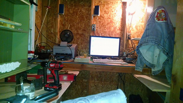

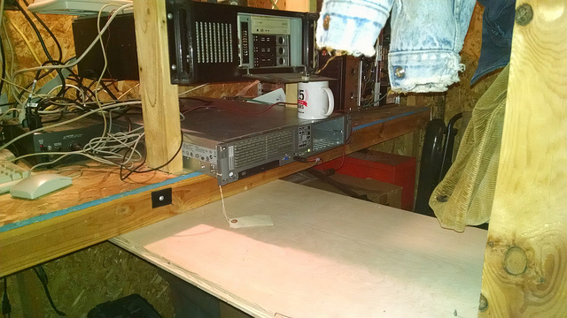

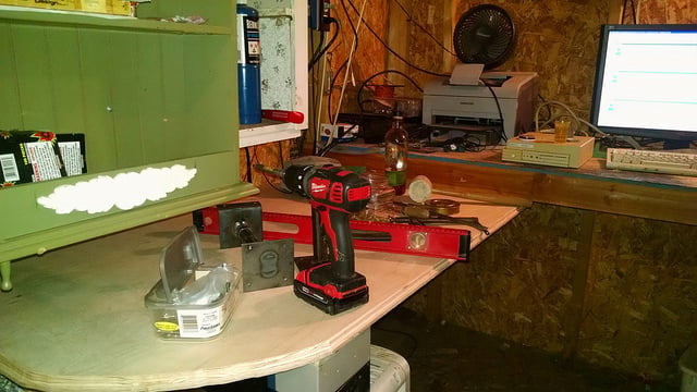

Reworking the electronics storage shed after a brutal cleaning. Adding a few worktops of marine quality plywood . Need to round a few corners and sand the routed edges smooth but it's lookin OK for a future bench.

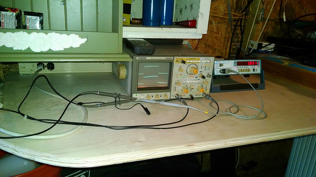

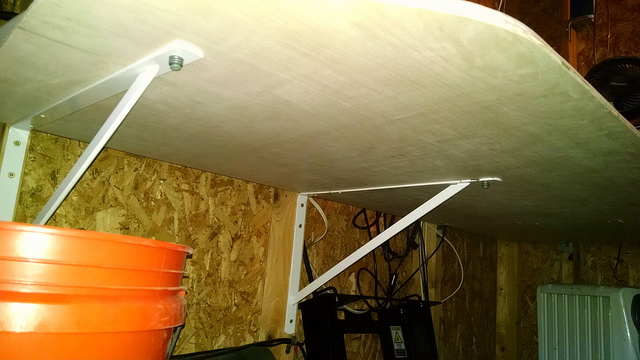

Connected a bench power strip to a spare breaker on the panel and 'boom' we have power for some old stuff on the new bench.
Very solid with #10 3inch screw attachments under the original bench and to studs for the shelf support.
That scope is a DSS5020A by KIKUSUI. 20MHz analog and 280 kHz digital storage bandwidth with 1024 words per channel. Worth about $100 on ebay for some crazy reason.
https://www.kikusui.co.jp/kiku_manuals/D/DSS5020A_E.pdf
1.3GHz Tek CMC251 counter with my old Fluke 12 meter.
