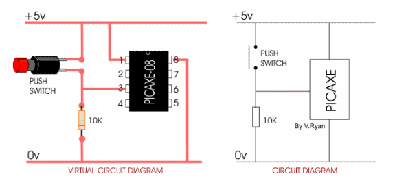

It would help us, help you, if you provided a more complete description of the situation.
You have not said what picaxe chip that you are using.
You have not said how you have the switch hooked up to C.1.
You have not said what lcd screen that you are using or how it is hooked up.
That being said, I rewrote your program to remove ALL of the LCD commands.
I hooked up a switch to C.1, using a 08M2 chip, exactly as illustrated below (from http://www.technologystudent.com/pics/outin2.htm)
except that I connected the switch to pin 6, rather than pin 3 as illustrated. On the 08M2 chip, pin 6 corresponds to C.1 and pin 1 is Vcc.
You are using a different picaxe chip (since you refer to a B port). The point is that the switch needs to be configured as the diagram below shows and it should be connected to the pin representing c.1
Below is your program, modified as I said. I also added statements to print the random number and to print which of the 'show" routines it goes through. The debugging print outs are accomplished using the "sertxd" command. When you run the program, open a "terminal" within the picaxe editor (see the picaxe manuals for detailed instructions, but it is quite easy). The output of the "sertxd" commands go to the built-in terminal in the Picaxe editor. In this way, you can see the random values and see where the program goes.
Before you run the program, remove all of your connections to the LCD screen and make sure that the switch is hooked up correctly.

Sorry I am using an 18m2, I can make it work using an 08m2. C.1 is hooked up as above but on pin 18 of the 18m2. The LCD works fine its generating the random number that is proving a little awkward. I have now used random w0, which is working but it goes through 9 times to 'showone' before it starts being a random number.

How is the switch hooked up, because until you press the switch, it should simply go get another random value without going to any show routine. That is what I showed you on the screenshot. Now if your switch is bouncing all over the place or is not hooked up correctly, that is another matter.
Did you run the program with the terminal program to display the output values or not?
I understand how tough it is to debug a program through messages, but you have to appreciate the fact that I already know how to write a program to simulate a die. If I am suggesting to you to remove the connections to the LCD and run the short program using the terminal to output variables, it is because I am trying to help you understand what the program is doing.
In these situations, there is a golden rule - "Divide and conquer". Strip the program down to a point where it works as it should doing something and build it back up.
There are two other issues to deal with once you get this far. The first is your switch processing, assuming that you want one clean press and release.
You need to debounce the switch input. Picaxe basic thoughtfully has a 'button' command to take care of this - check out the syntax and use it. Also, you want to check that the button has been released before you select another die.
