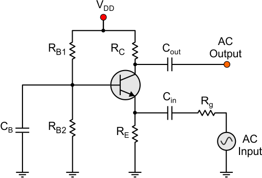

i need a help in the common base configuration
i have this circuit below
i need to draw its ac equivalent model but i have a problem with inserting the hybrid pi model or any model because of rb1 and rb2
they are supposed to be in parallel but where to put them in the equivalent circuit i don't know
in fact the hole equivalent circuit isn't so clear to me i find it difficult compared to the common emitter equivalent circuit

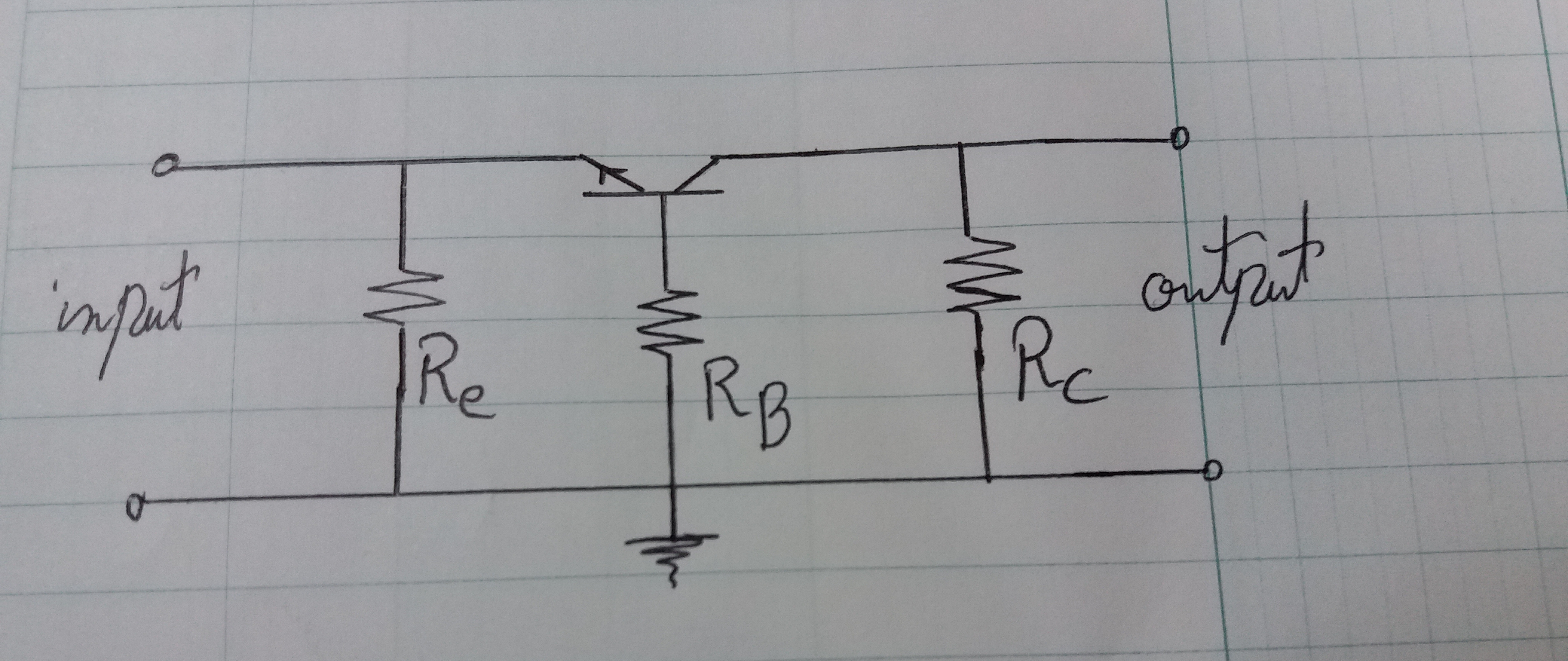

i know it's wrong but will it look like this ??
Ghina Bayyat
Joined Mar 11, 2018
151
WAIT
that's right i almost forgot they are gonna be shorted because they are connected to grounded base and also the other end of rb is connected to shorted vcc
WBahn
Joined Mar 31, 2012
33,324
what do u mean what does it look like ? if i knew i wouldn't ask i didn't know how to draw the equivalent circuit
do u mean what is the circuit's behavior or something like that ?
It's going to always be very hard to draw AC equivalent circuits (better known as small-signal equivalents) if you don't understand the major functions of the parts of the circuit, if for no other reason than you don't know which components do and don't get included in the equivalent circuit, let alone why they do or don't.
What's the purpose of Rb1 and Rb2? It's to set the DC bias point of the transistor.
What's the purpose of all of the capacitors? It's to separate the AC operation of the circuit from the DC operating point. As such, they are chosen so that their impedances at the frequencies of interest are low relative to the other impedances.
In particular, Zcb << Rb2. So what does that imply about the base of the transistor at signal frequencies?
Ghina Bayyat
Joined Mar 11, 2018
151
this means that the resistors connected to the base won't affect the small signal and it won't pass through them so in this case they won't get included in the small signal equivalent circuit
