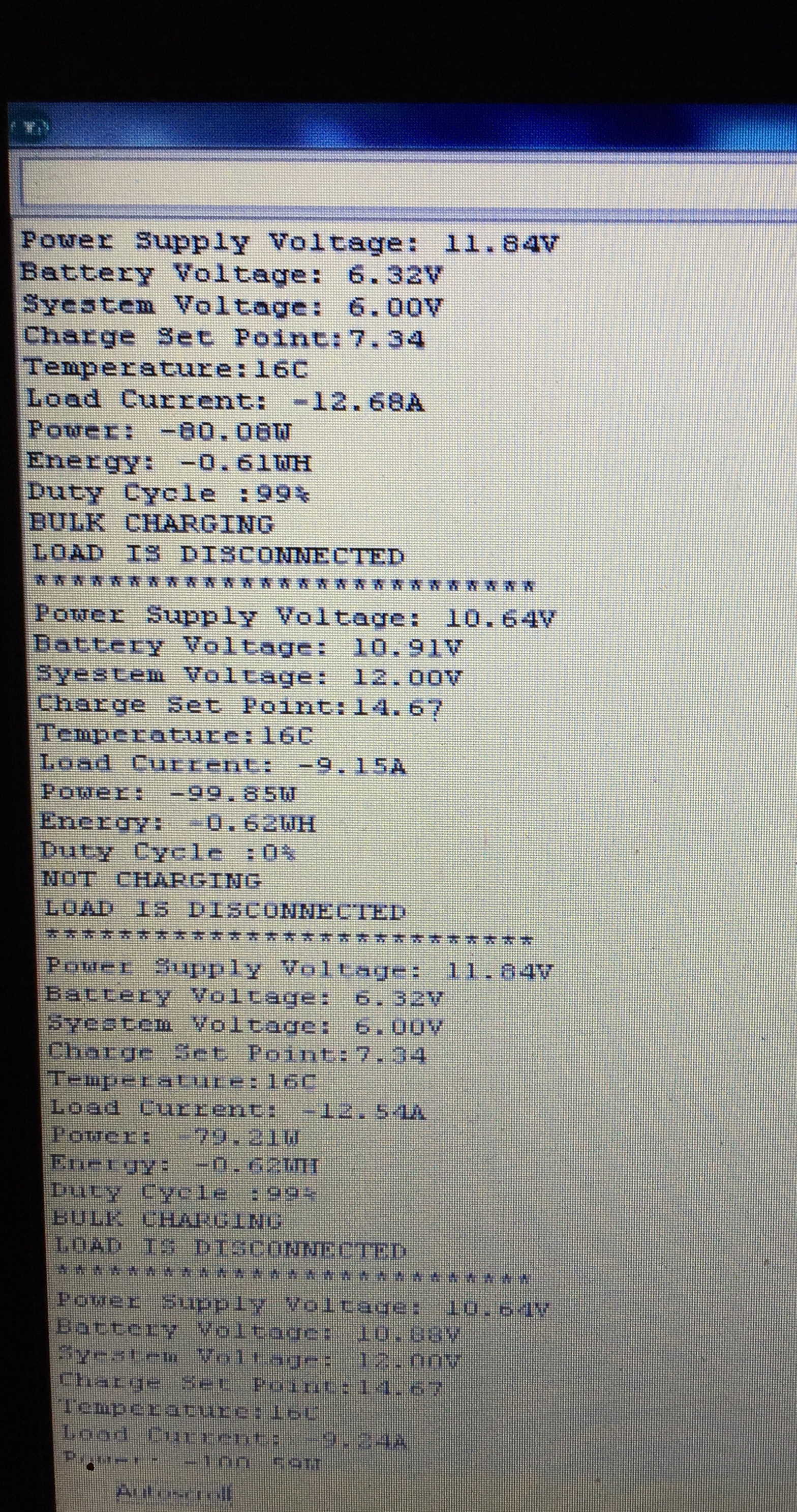

i think its control the voltage !
mosfet reduce the solar voltage to the battery volatge
If you're so smart why did you ask the question? I think it is a voltage controlled current source. The control is PWM and it is true that the voltage increases along with the current when the switch is on and it decreases with the current when the switch is off.

he write that the mosfet control the voltage i don't know ، i just ask you to give me more details
so as you say it control both the voltage and current ?
can i charge a NiCd battery ?

Well look at the characteristic curves for the device. Don't they show drain current as a function of Vds with Vgs as a parameter. Draw a load line and notice how when you increase Vgs you increase Id and decrease Vds. It is true that the Arduino is monitoring load voltage. I would infer from this that there is a battery charging voltage profile that the Arduino is looking for such that, as the battery approaches it's fully charged voltage the charging current and thus the duty cycle is reduced to what is called a trickle charge.
As long as you can monitor what is happening with the battery there are numerous designs that can be used. I don't see any facility to monitor battery temperature. Seems to me that would be a useful feature.

temp. sensor not a solution to monitor NiCd battery ?
