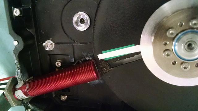

Gear sensor for metal tab on disk platter (painted flat black) hole with white tape indicator line.

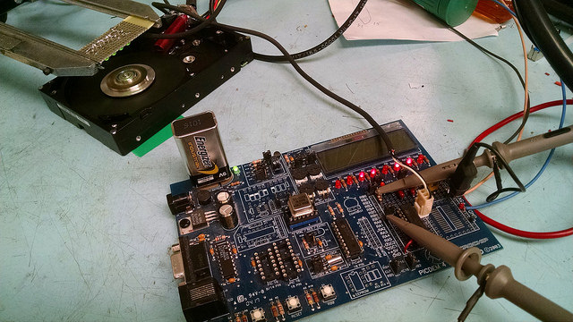

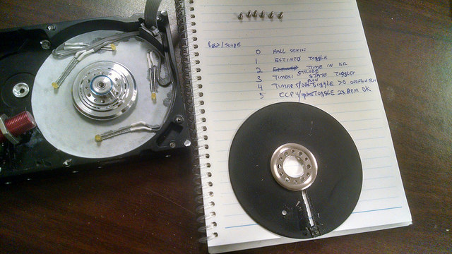

Rube Goldberg HD POV edition. :D
Rube Goldberg HD POV edition V2.
4 position LED flasher.

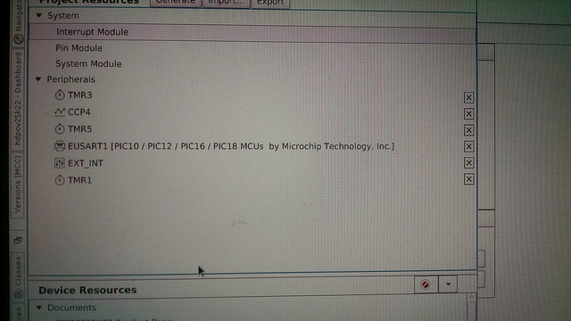

mplabx 5.10 MCC with XC8 V2.00 C99 mode. Some of the code is leftover from the RGB line flasher version.
Source Code:
https://github.com/nsaspook/25k22_hd_pov
ISR latency and jitter from hall sensor trigger.
Uses a simple SM sequencer to update pattern datas to the HD display line converter SM.
